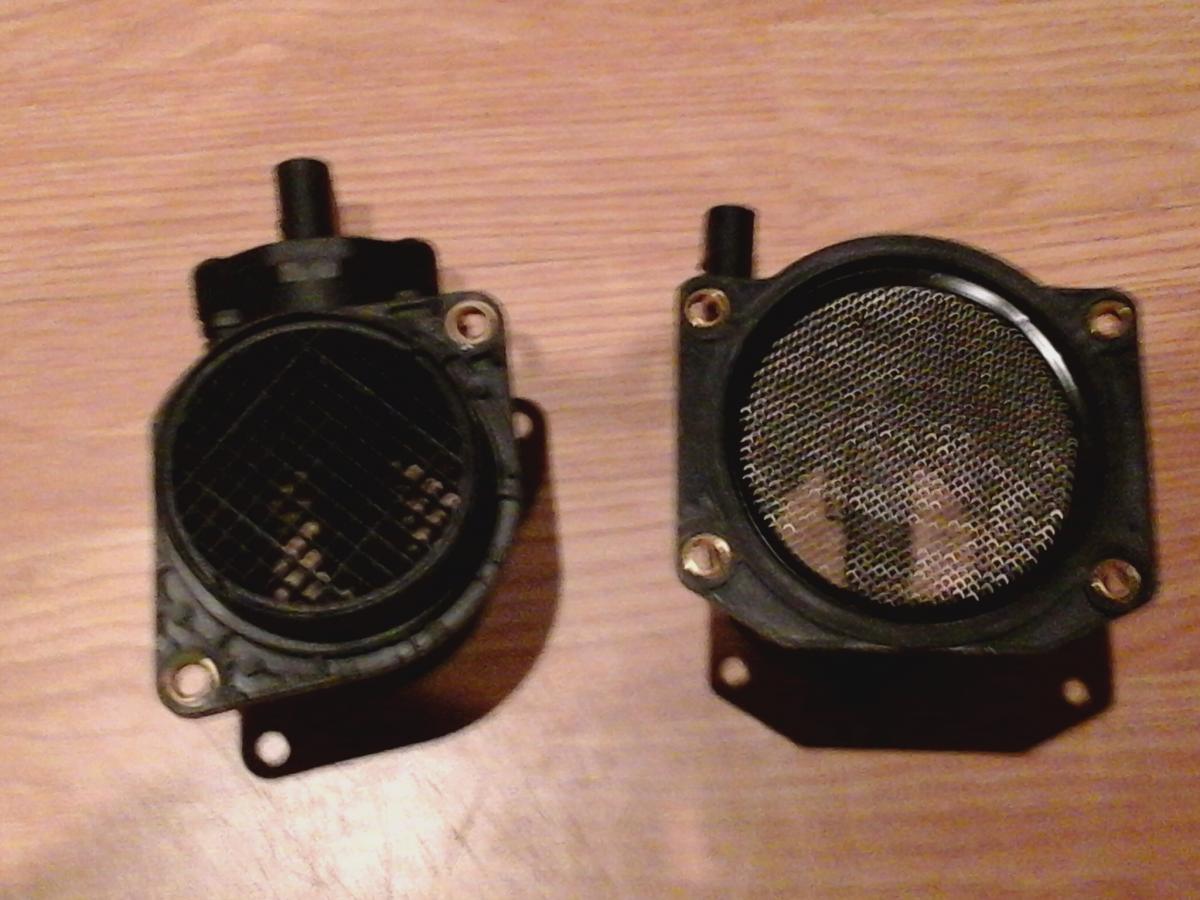

Order a refurbed Bosch Maf (part no - 06A 906 461.) Maf arrived looked like new, of course to good to be true - wrong part!!! The part no. i require is 06A 906 461B.
So i searched high and low for a Bosch MAF w/ that elusive B. I don't think it exists.
Now I did happen upon a Hitachi MAF, part no. 06A 906 461B, great i thought -  then i read this http://forums.vwvortex.com/showthread.php?5707395-Bosch-maf-to-Hitachi-maf basically if you change from a Bosch to Hitachi the ecu must be reprogrammed. Is this correct?
The Hitachi MAF has the VW logo so I'm hoping that it is an OEM part.
Ne thoughts?

I thought the same about the 'B' at the end of the part number (based on previous purchases of OEM parts where the last letter didnt  make any difference to the part, maybe newer as you've just mentioned) but I have the two MAF's they are different
So, moral of the story when ordering a MAF, make sure the part no. is exact!

As far as i can see, the OEM of the MAF (06A 906 461B) for the Skoda Octavia Mk1 1.6 AKL is Hitachi, so I ordered a refurbished one earlier today.

Just for a comparison I've attached a photo of the two MAFs that i ordered. The MAF on the lhs is part no. 06A 906 461 & the rhs part no. is 06A 906 461 B
Neway, I fitted a Hitachi MAF w/ the "B" and the idle improved and no sputtering,  but the car is hesitating and i can heard a tick..tick...tick...

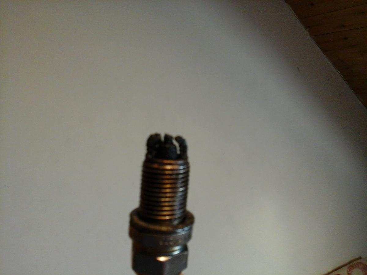

^A quick update. After fitting the refurbed MAF, the engine was still sputtering, so with the engine running i removed the HT lead for spark plug 1, nothing happened so I removed the spark plug, have a look at this!
I think its seen better days
