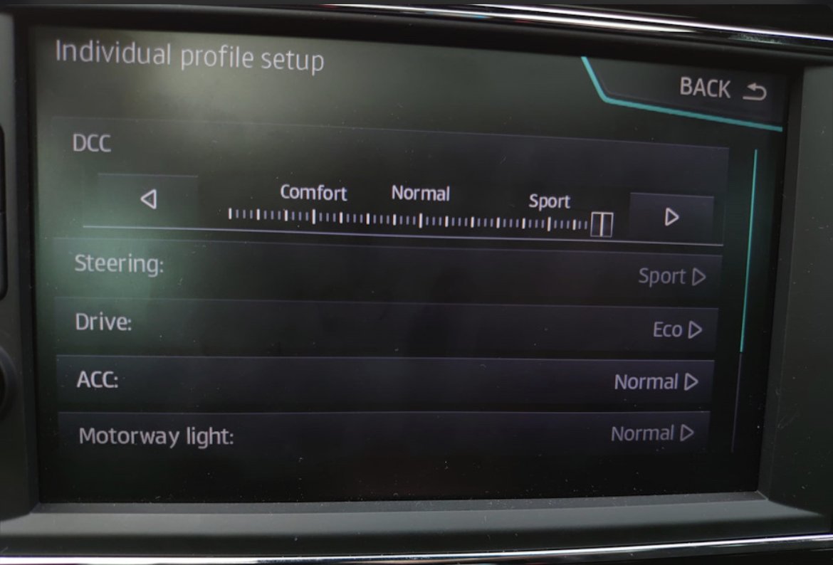

2020+ Arteon and Passats equipped with DCC now come with a slider in Individual driving mode that allows you select DCC settings from 0-15 instead of just Comfort - Normal - Sport. This allows settings softer than comfort (LOL), firmer that Sport and everything in between.
Photo below for reference.

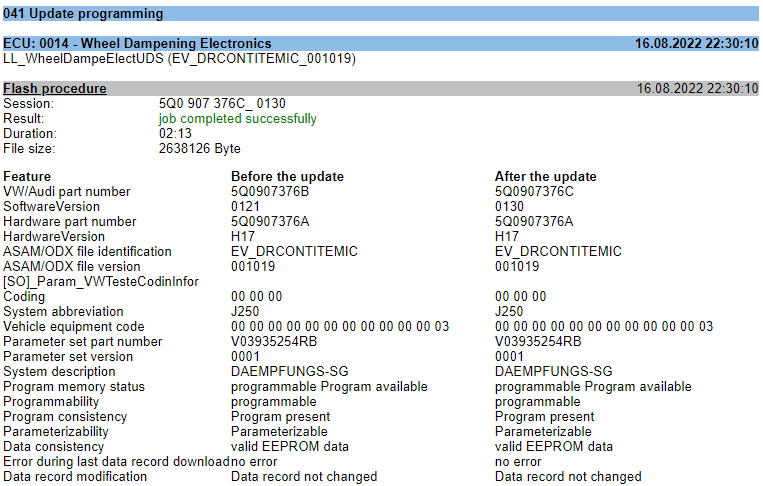

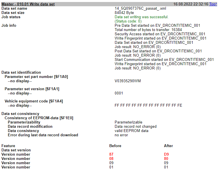

  • Well that was all surprisingly easy...   Flashed the DCC module:   Uploaded the Passat dataset (closest in size, weight and wheelbase to the Octavia):   I alr

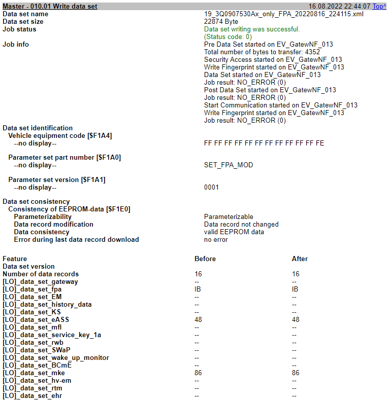

  • Ok, with some serious help it's been done!   Here is the overall sequence of events that was encountered and followed: Original gateway was 5Q0. Most examples seem to use the 3
  • Youre in luck, this is what youre after.   https://www.glaskugelservice.de/codierung/dcc-auf-index-c   https://github.com/jilleb/MQB-FPA     The first link is bringi

The second link is the CUSTOM driver profile file you have to make to accommodate the new values 1-15 not 1-3.
Should be all you need.

Ive now got 2 GATEWAY datasets for a superb - They are unmodified - Im not saying use any of this stuff without triple checking its what you need. The 2 gateway files below may come in handy for someone to tinker with and experiment with the slider. I personally wouldnt upload to the car though.
If I was you guys, I would find someone with ODIS, pull the original file from your vehicle and intercept it. Modify it to your liking, then offline upload it. If you do it any other way with someone elses dataset you risk not having the correct data on there for your car.

FL_5Q0907376C__0130.odx looks like an ODIS flash file.
FL_5Q0907376C__0130.xml is basically identical, a name field changed from Henno to Stephan Pölzl.
leon_dcc_5q0907376b.xml is slightly odd, it's not a ODIS XML dataset file, it might be some VCP thing as it appears to contain a number of different datasets...
The missing part is still a publicly available C rev dataset, the B rev won't work :)

Apologies. Seems ive updated both flash versions in odx and xml. The 3rd one is dataset but for B version.
Ive attached C version Arteon dataset as you need.
14-Arteon DCC 5q0907376C.xml
Edit: Ive also attached a passat dataset
14_5Q0907376C_passat_.xml

Honestly, hard to tell as it's a very subjective thing...
I'd probably say it's a little softer and harder than before but I don't think there is much in it, especially as I'd typically be in normal previously so I don't have a decent baseline.
I've tried a few settings today and settled about half way between normal and sport. I was hoping for more granularity rather than being able to set it softer or harder so I'm happy at that :)
