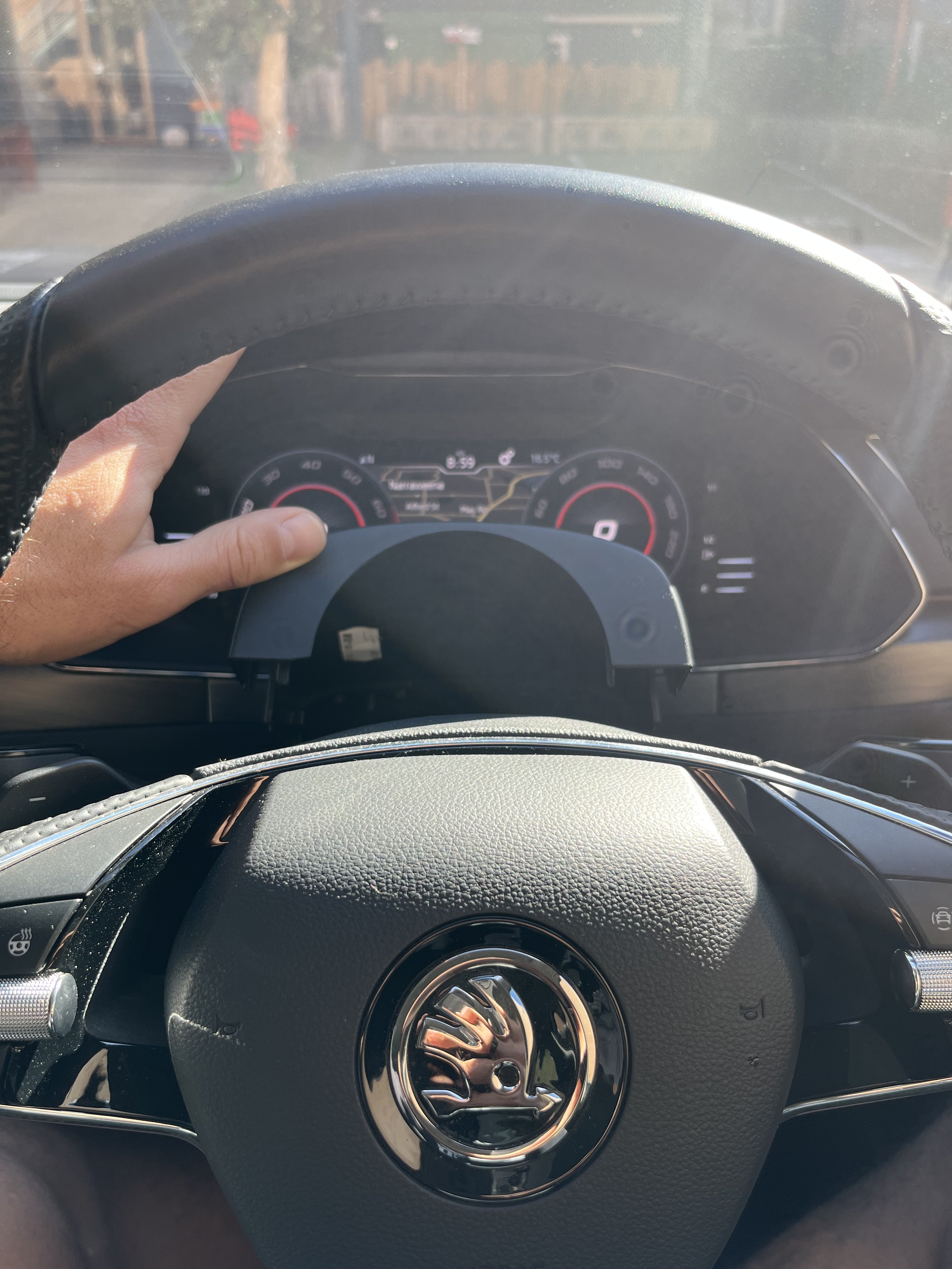

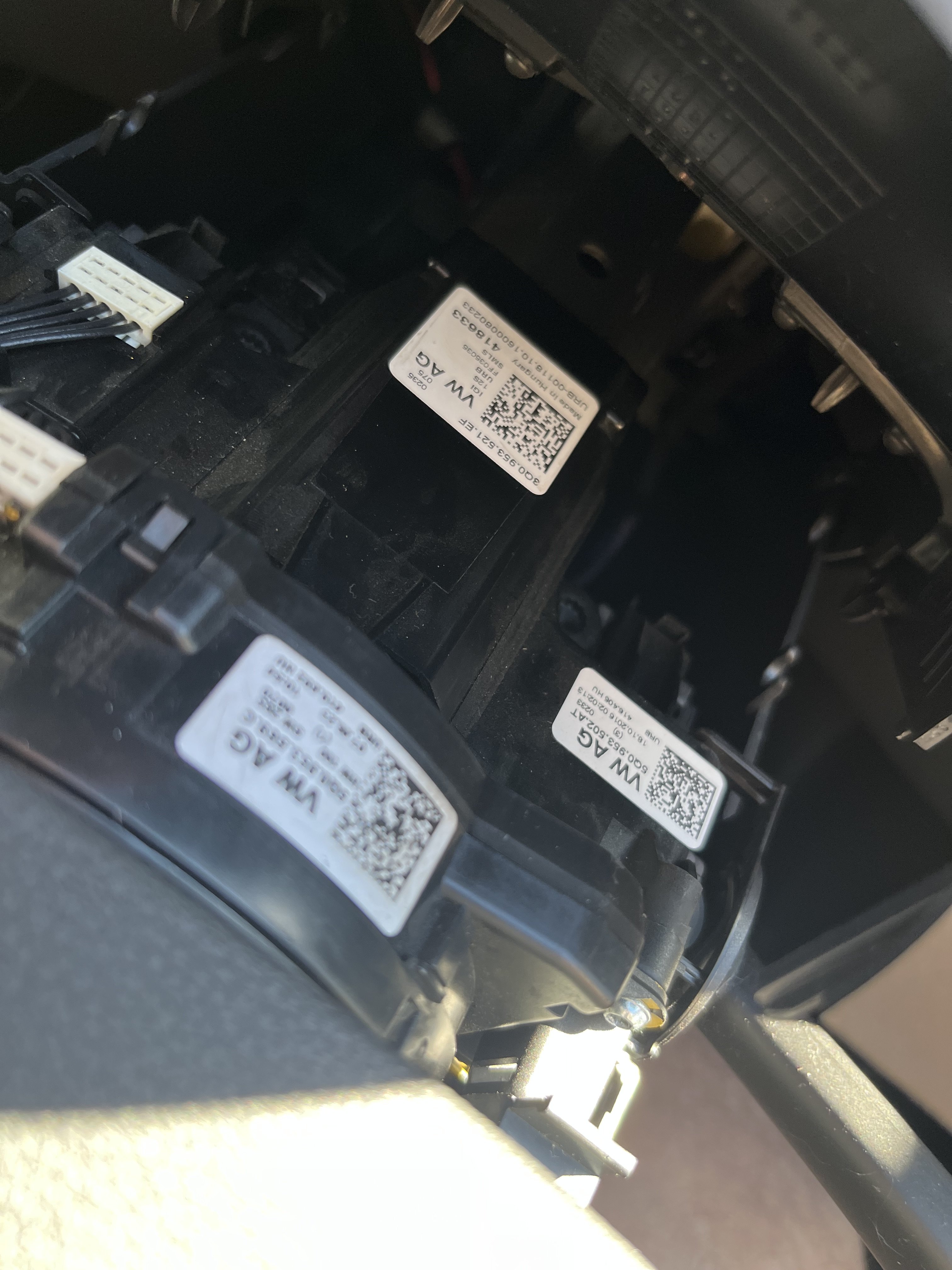

  6. Just take your steering wheel trim off and check your clockspring part number. It’s dead easy as the part labels are on top of the steering column when you pop it up. Don’t even need to remove the wheel. Here is mine in my 2017 Superb. Obviously once you know what clockspring you have you’ll know which clockspring you’ll need and hopefully which version of the loom you’ll need. This link will be helpful as they talk through the wiring in the plugs. You could even reach out to them with your specific questions. https://wirer.sk/o3_volant22-vyhrev/

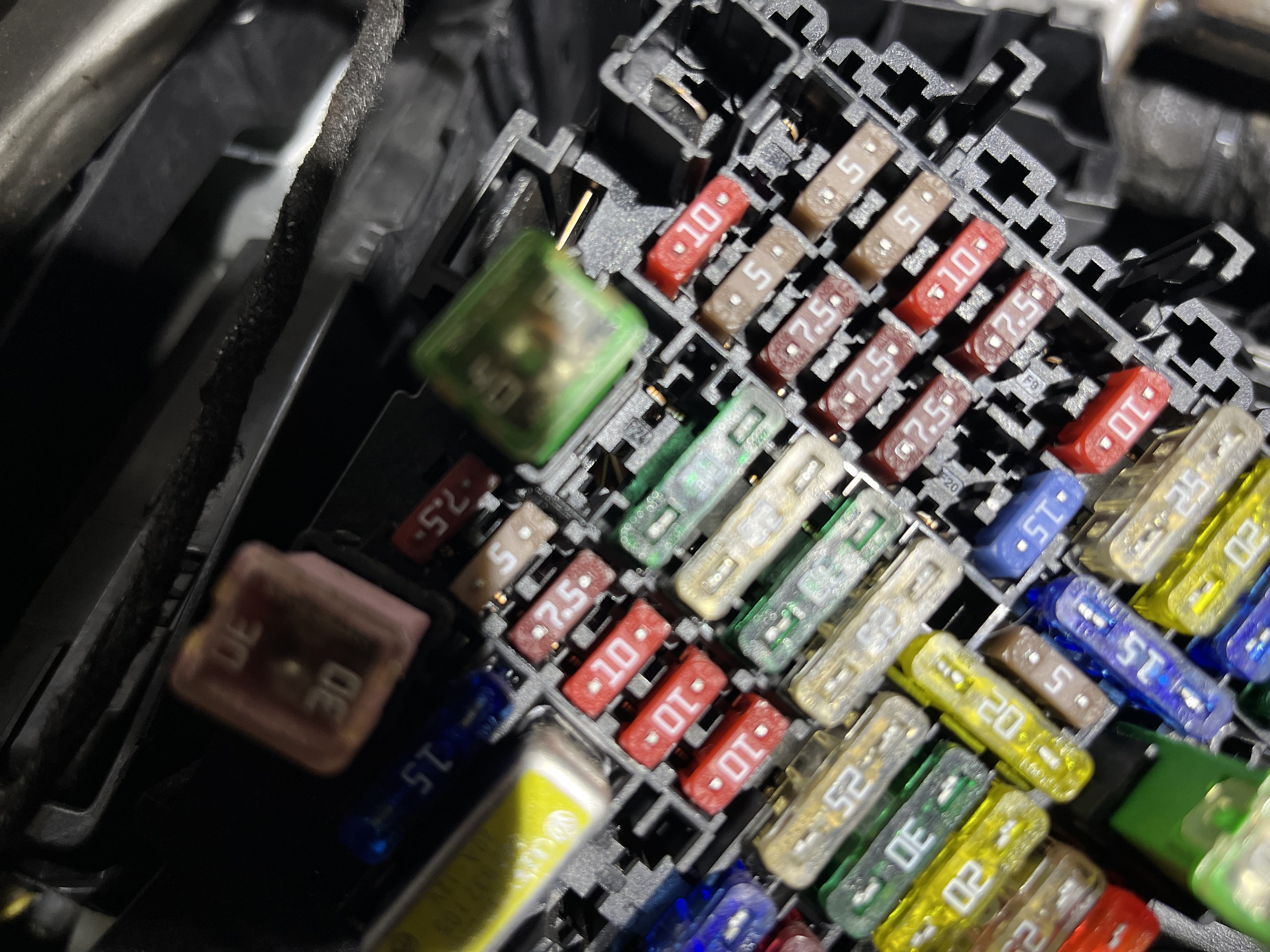

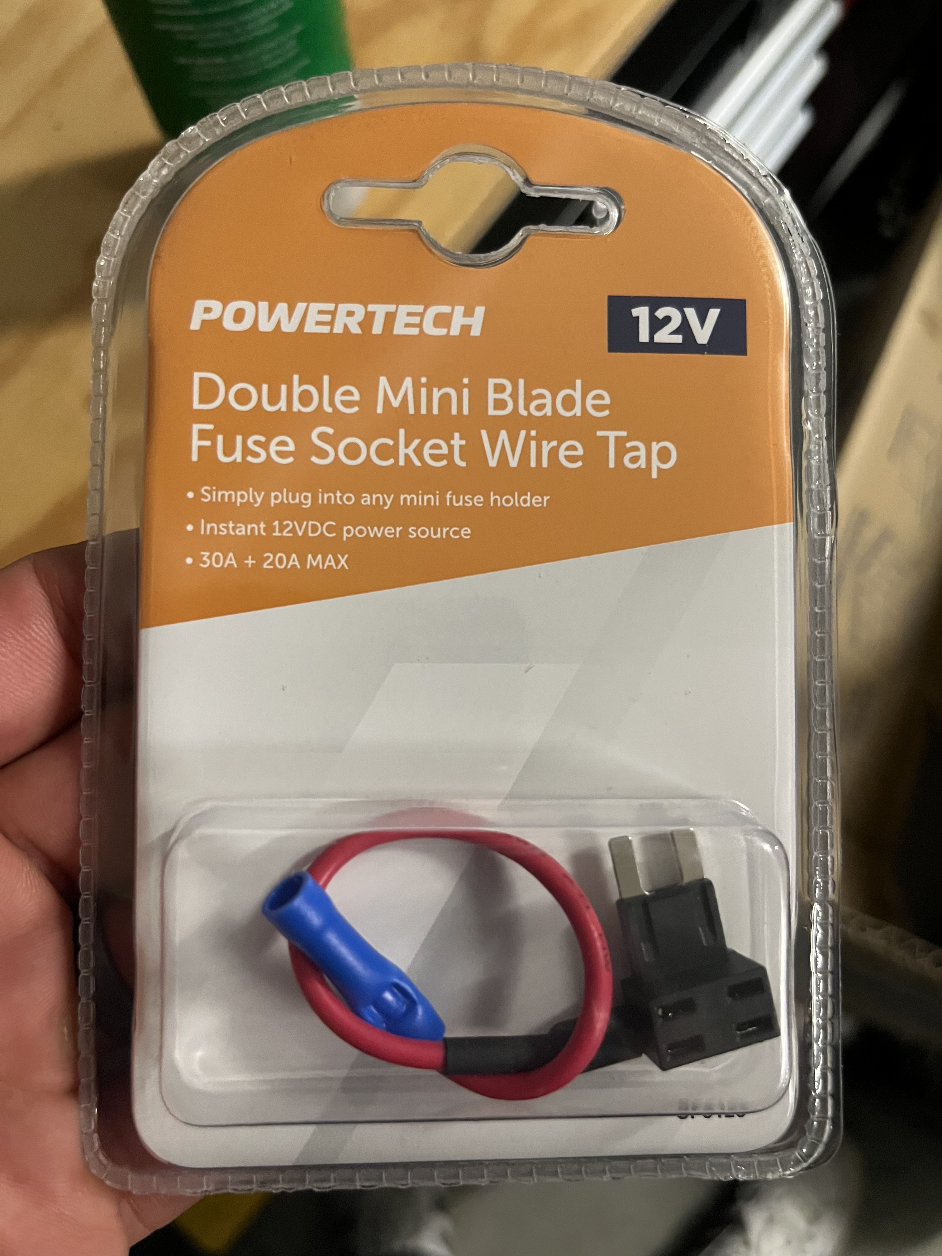

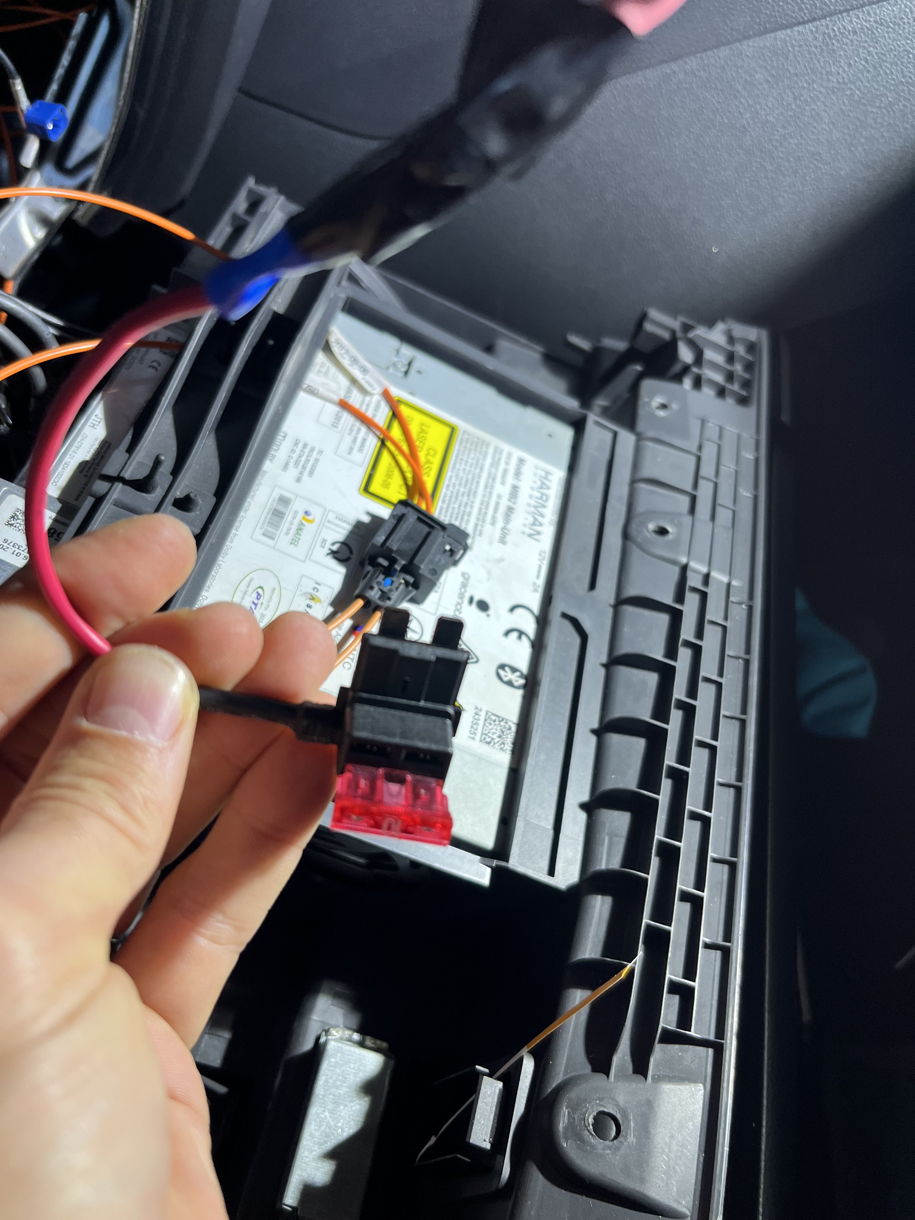

  9. Wanted to say a big thank you to everyone who contributed to this awesome thread. This thread including all its links has been pretty much everything I needed to get this done. Summary is: 2017 Superb 206 wagon. Wheel 5E3419093AM VKJ Airbag 5E3880201D IZY Clockspring 5Q0953569C Kufatec HSW retrofit loom 43696-1 (extended for RHD) LIN bus adapter cars Equipment full function LIN adapter. Along the way I figured a few things out: The clockspring 569C needs to have software (SW) version equal to or later than your current SW on 569A. You can skip pulling the fuse panel out and messing around with the wires at the back by using a fuse wire tap (see pics). Let’s you plug straight in, cut off tip of Kufatec loom positive wire and crimp into the fuse wire tap. For me I had an unused terminal 30 fuse at SC24 (see pic below. Empty slot in middle of pic) which was for a sunroof I don’t have. The rear wiper fuse spot will also work for sedan cars. Overall thrilled and very happy apart from my MIB 2 high nav showing my location about 2km off actual location. I guess you can’t win em all 😂.
  10. Ok. Mission accomplished! Using the Kufatec loom (LHD) on a RHD Superb with some wiring extensions, the Cars Equipment LIN adapter (full version), and a 569 C clockspring, it all came together. The magic sauce was using a fuse wire tap in an unused Terminal 30 location. For me that was SC24 where the sunroof fuse goes (I don’t have a sunroof). The good thing about this is you don’t need to get behind the fuse panel, literally just need to find an empty slot with a positive terminal 30 socket wired, plug fuses into the tap and crimp in your positive wire from the heated steering wheel loom in. Lesson learned along the way was that not all 5Q0 953 569 C clocksprings will work. You need one with a SW version equal to or later than yours or the adaptation coding in 08 HVAC won’t work. Sadly sold it already, soz!

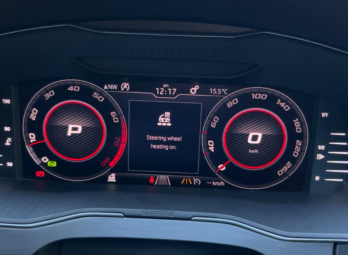

  12. It will eventually. I have to install the Kufatec wiring loom, clock spring and do all the coding to make that work. Hopefully by next weekend. Once done the MIB holds a bunch of settings for it under Air Conditioning.

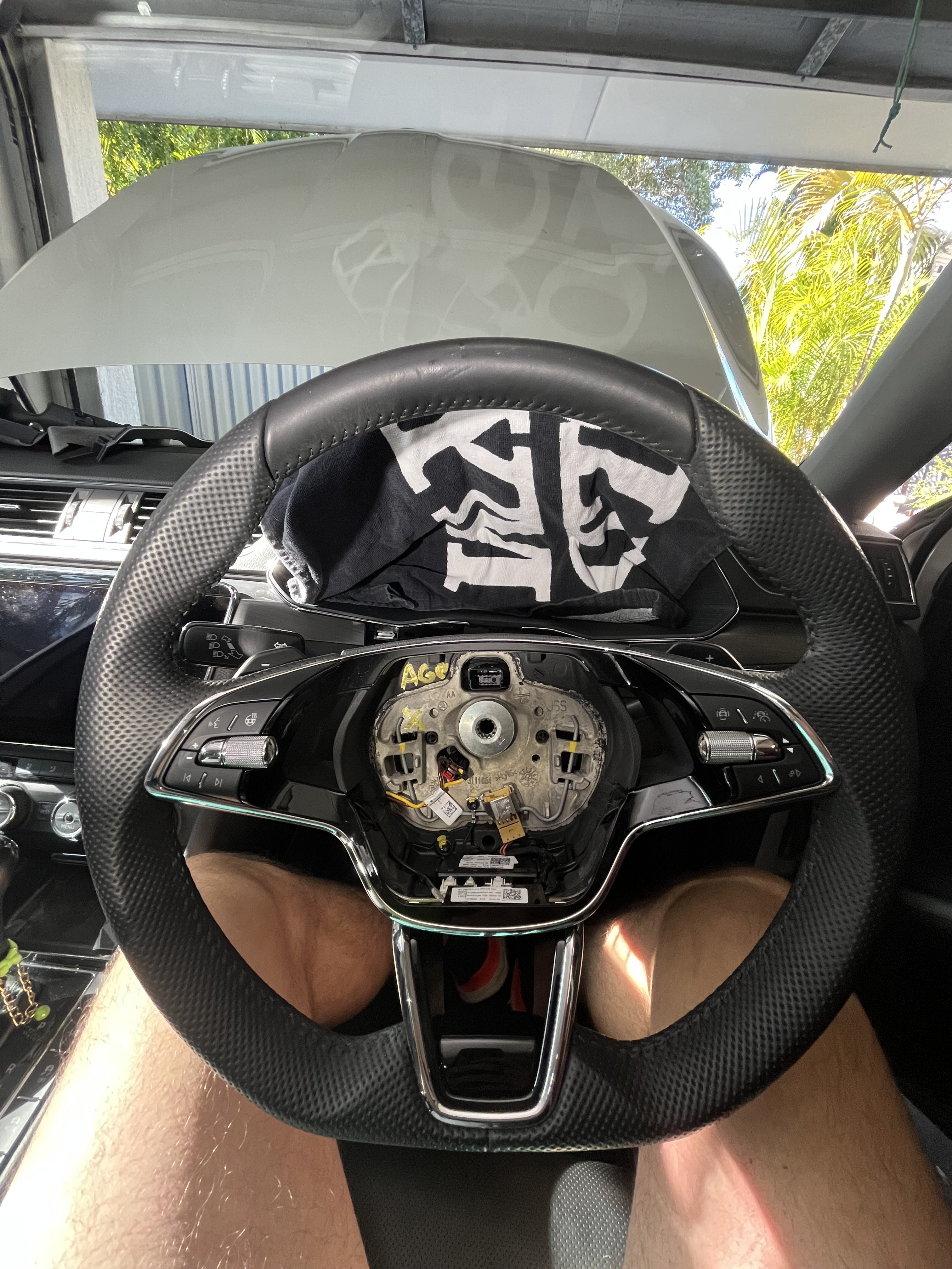

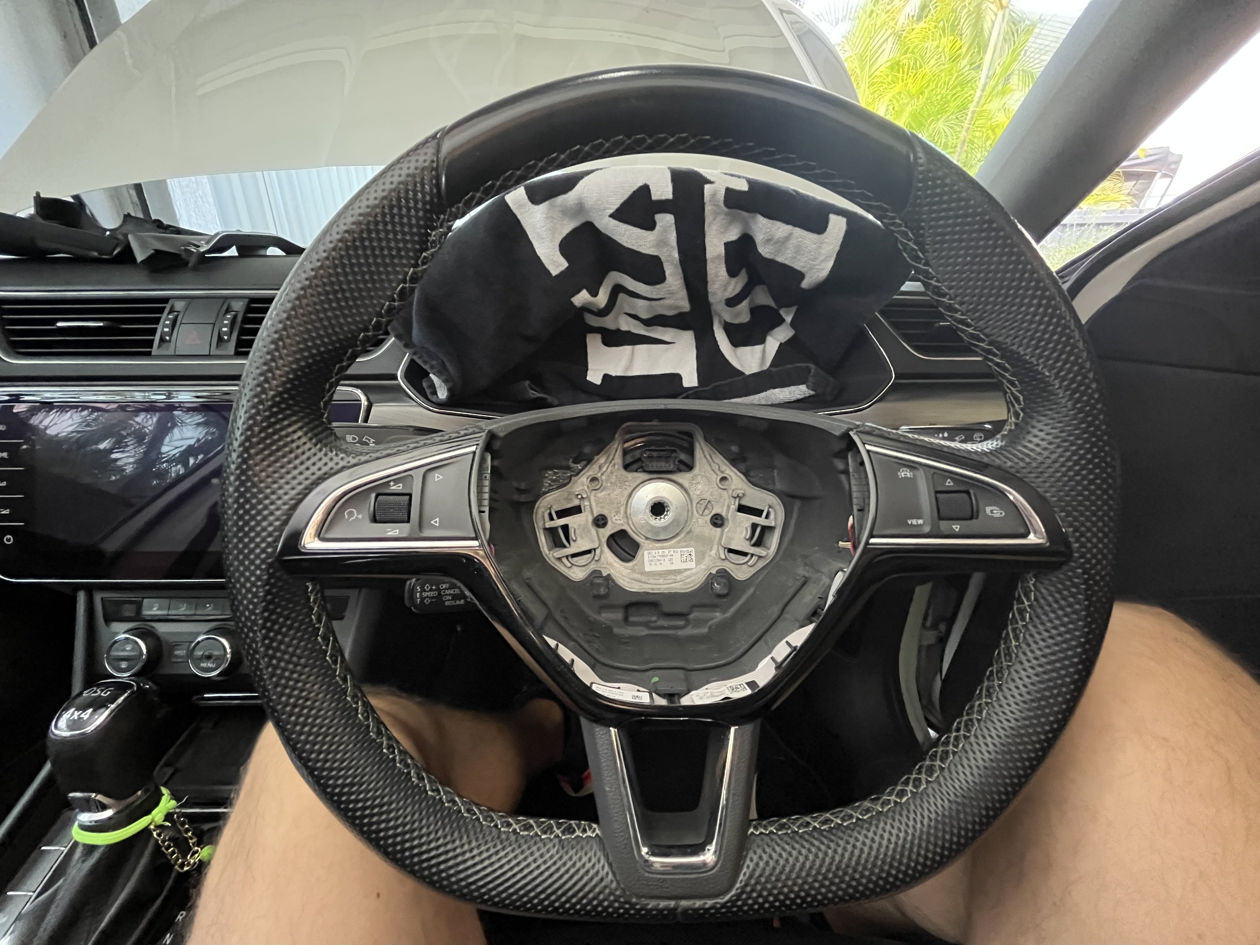

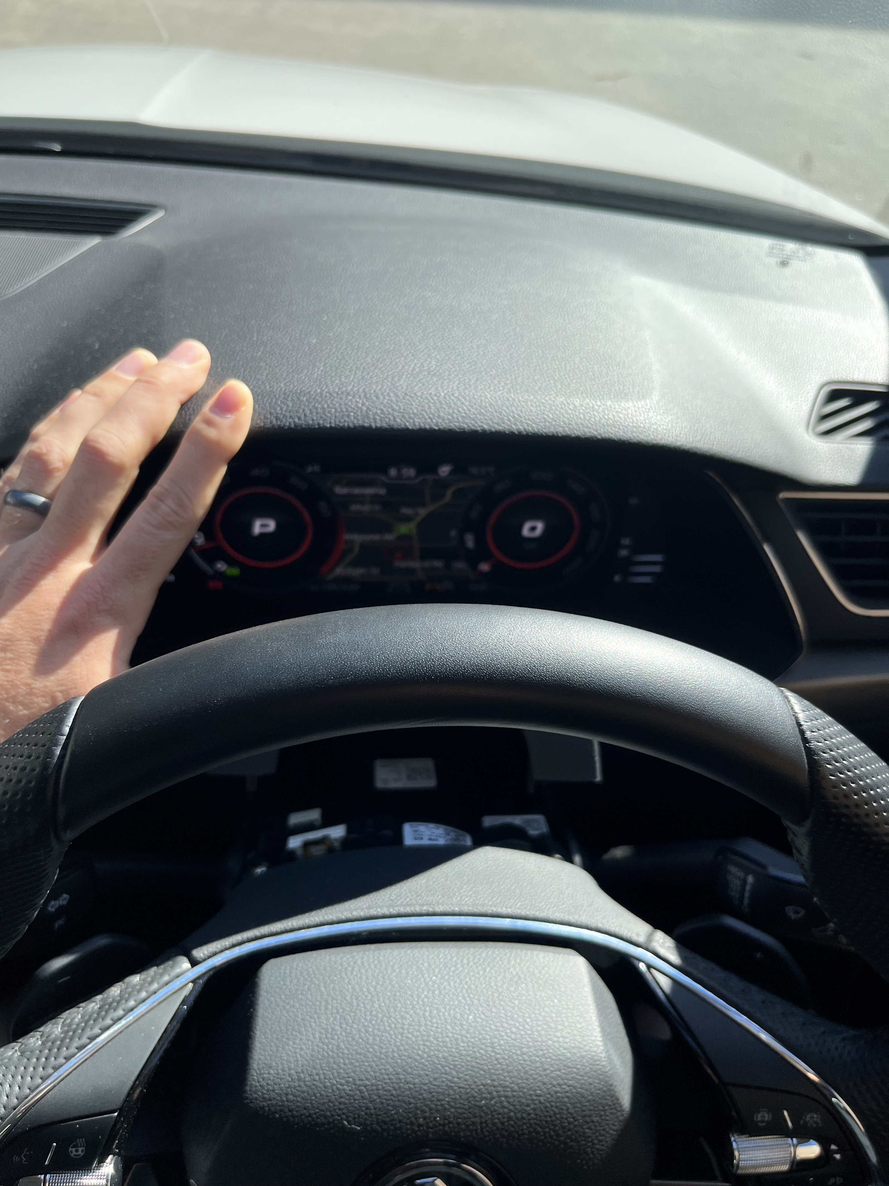

  13. Ok, test fitted the wheel with module and everything works except the heating button (as I haven’t wired or coded it yet) and the ACC button as that requires coding to work too. This is using the cars equipment full function LIN module. Very happy with the progress so far! Apologies for the chicken legs in the photos, promise I’m wearing shorts!
