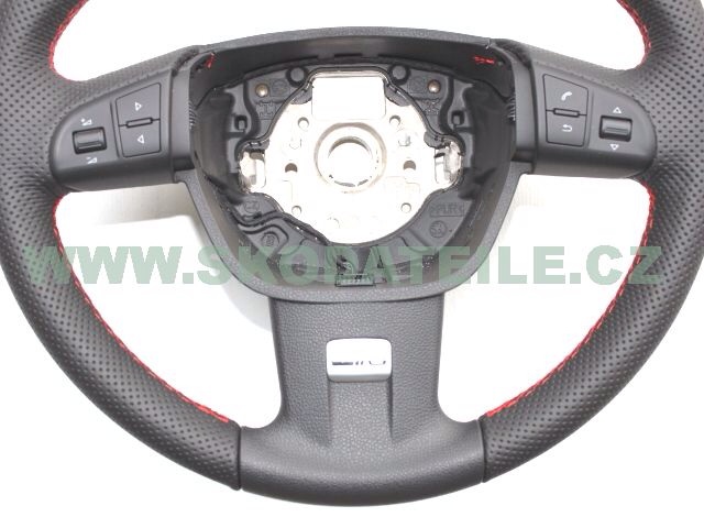

So this is the wheel I'm getting, witch parts will I be needing? I'm gonna check the controller part with vcds
I think that's a MkII wheel.

71851-11792f85afa119a0bf34d7fc972325fd.j
Copyright: MatzeJ
SW: 5E0419091K
Airbag: 5E0880201
MF from Superb : 5E0919719F
Airbag Cable: 5JA971584
