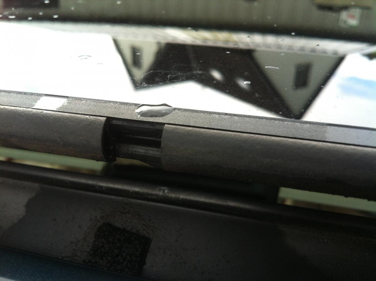

There is about half an inch gap at the rear of the sunroof seal

I will post a pic soon
this is a photo of my sunroof seal
the gap is about half an inch in the centre at the rear, it lets quite a bit of water in
can anyone have a look at this and let me know if the gap is meant to be there
Mine has the solar sunroof. I have a gap of around 5mm on the seal on the furthest back edge of the sunroof glass. (I guess that is what your photo is of)
But... there are actually 4 drains around the sunroof opening which are to let water run out to the bottom of the car - and I don't believe it is meant to be totally sealed.  The front two exit to the front door jambs (black teat like things) and then two exit to the rear wheel arch.
It sounds like you might have the fairly common issue of the sunroof drains either being blocked up, or disconnected (there are tubes running down the pillars to the back of the teats etc).  The way you check is to put the car on the level and slowly pour water into each drain location with the sunroof open.  It should either exit to the rear wheel arch or the front door jamb (depending on the drain you are testing).
The tubes I believe can become disconnected at the top (you get water dripping down the headlining) or bottom (similar water ingress to pollen filter etc).  If the tubes are blocked / backed up then they leak from the headlining.
