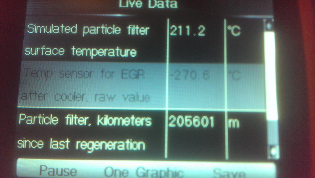

Thanks for the reply, on the engine I have their is an egr cooler this use the engine coolant and Is circulated by an electric pump I think this reduces the temps of the recirculated exhaust gas before putting it into the inlet side ( I think). I think I found the problem the egr temperatures father the cooler is reading -270 I know is getting cooler but not this cold! Just as a matter of interest there is no faults stored in the car.
The temperature sensor seems to be faulty. The car won't give an error code because it's getting a temperature even though it makes no sense.

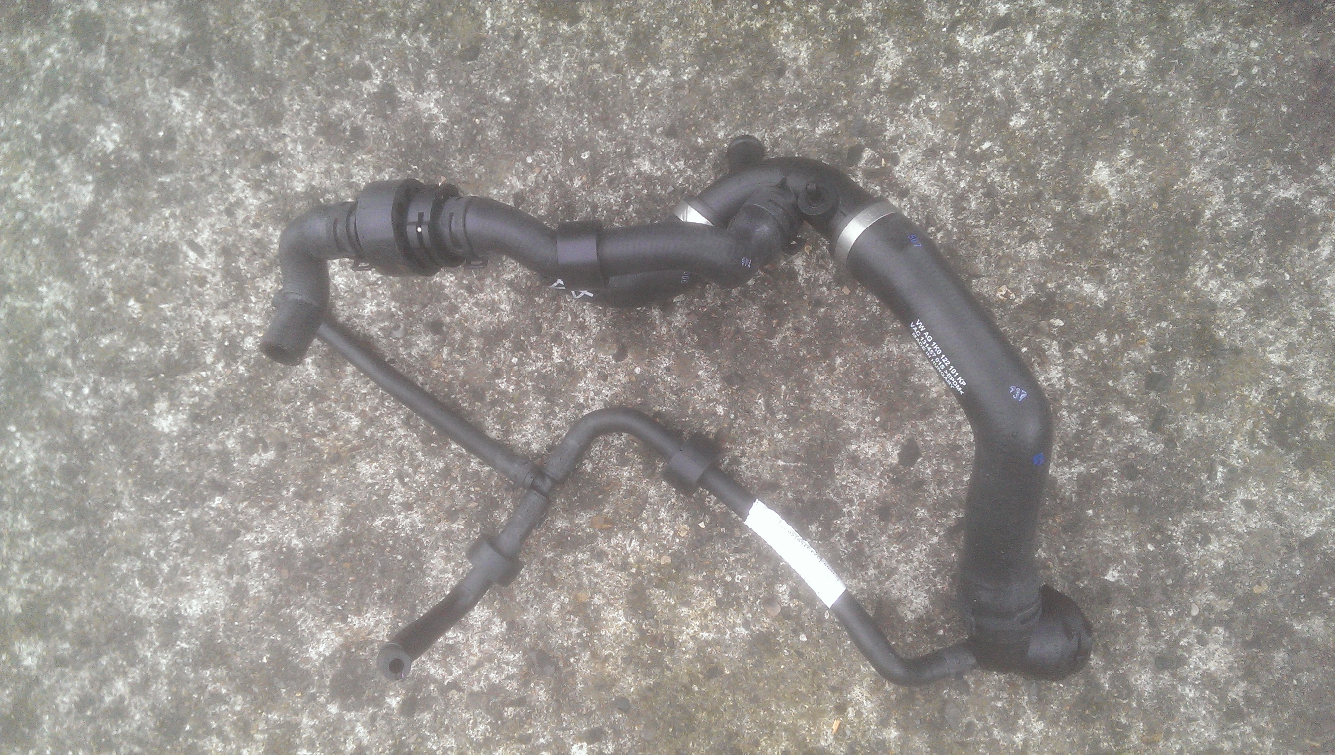

Well all after much head scratching and cursing I fixed the issue with slow heat up and cooling down on the motorway. It was the coolant stat for the dsg gearbox, my local skoda garage has never sold one of these before it's easy to fit but can't be bought without the hoses. See photo. Anyway hopefully no more issues with this beast

I'm having the same issues that you're having, low temperature and slow heating. I have the webasto heater that's working all the time. I've changed the engine thermostat without any change (4h in the shop for they to find the fault), that wasn't any fault. A real hassle to change.
I also have the DSG gearbox and I've found out that the part number for the Coolant stat for the DSG is 1K0121113A and you can purchase it on ebay separetely from Mahle.
