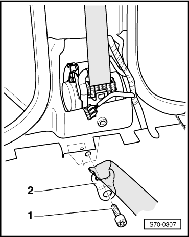

I've managed to remove the trim around the seatbelt down to the 'reel' and there's no loops, twists or jams.
In one forum it mentions "pre tensioner, inertia lock" but I've no idea how to release the mechanism in order to free up the seatbelt.
It looks a special tool and torque wrench are required if I want to remove the 'reel' and replace it. I'd obviously much prefer a method to release it instead.
