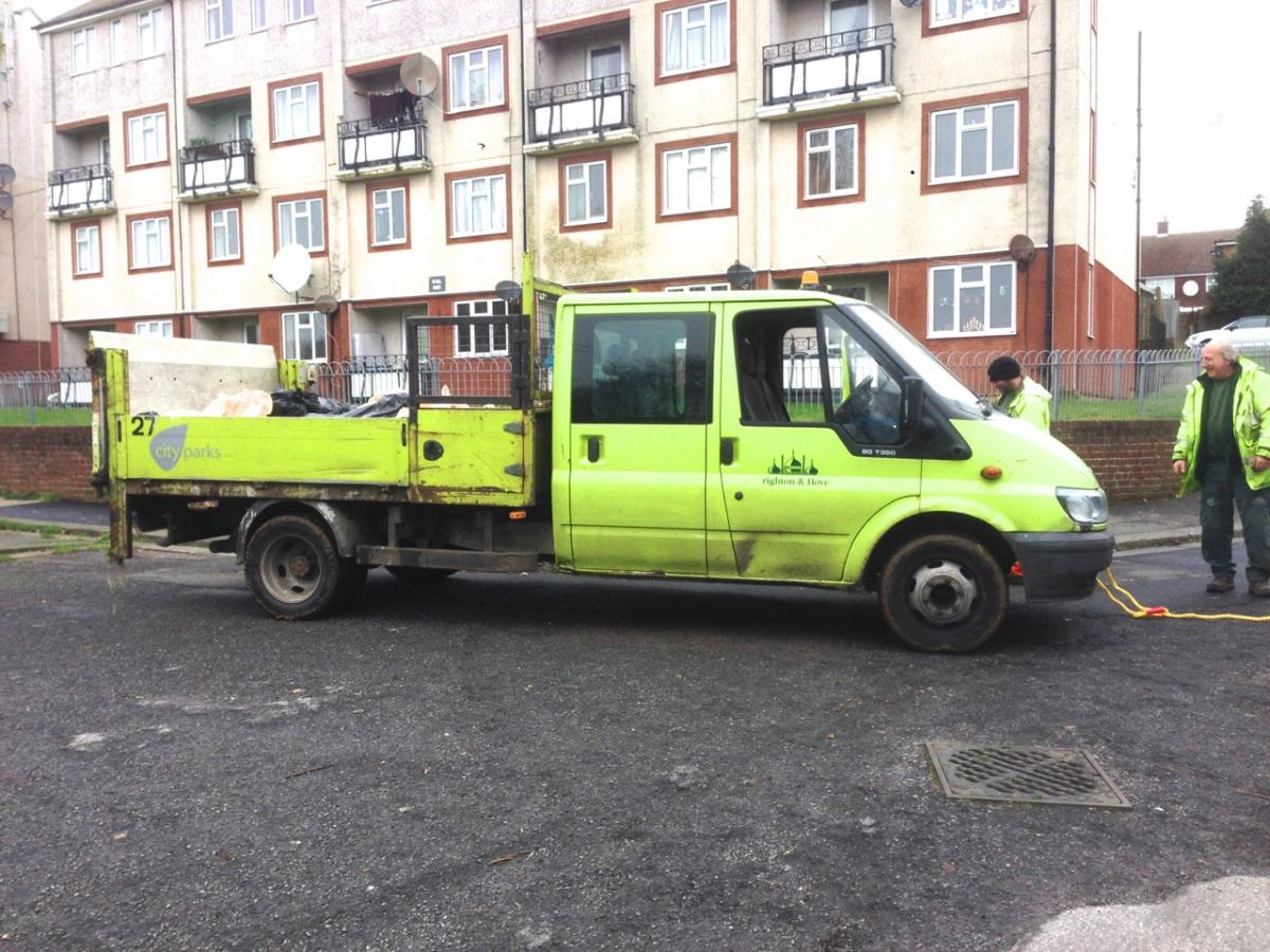

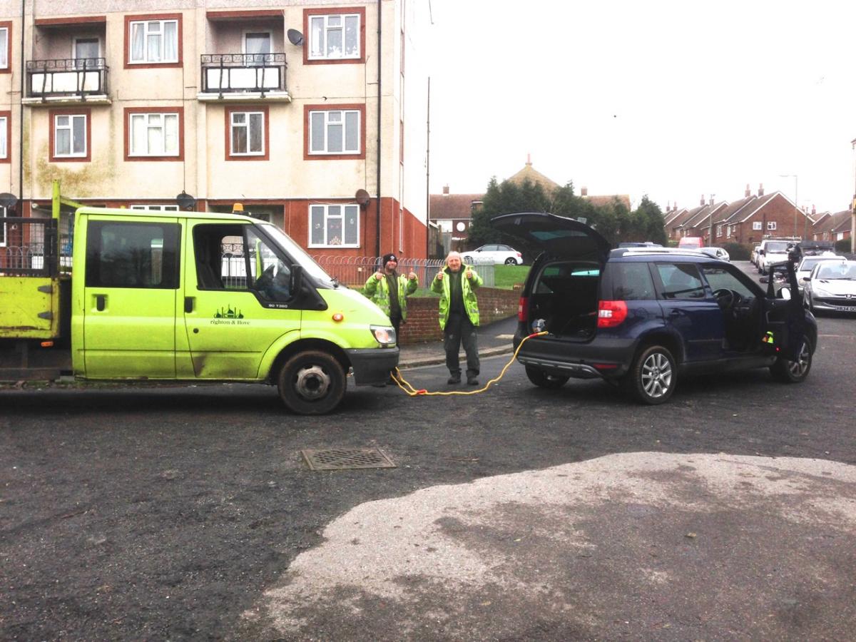

Last year one of the local council trucks got stuck in the local park as their wheels were unable to gain traction on the muddy grass.
I lept at the chance to show off the Yeti's prowess and ability, only to hear both the council men say "You'll never be able to pull us off with your yeti as our truck is too big and heavy.
The Yeti did it with ease, much to the total surprise and delight of the council men.
Pics are below.   :)
