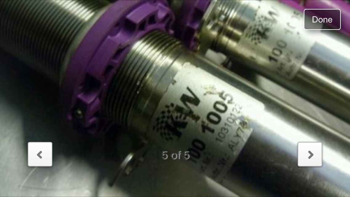

Hai
Will this fit on Octavia mk1 VRS ?
Kw v1 part number 1001005 , used in golf mk4
Edited by Raj M
The spring rates are all wrong as the Octavia is much heavier at the back than a golf. A common mistake is to buy a Golf setup and then wonder why the car handles oddly. KW make a specific set for the Octy MK1. You can see below the different KW V1 Setups for the two showing the different Axle loads.

As above, it'll fit but the rear spring rates will be wrong for the heavier Octavia.
The kit you need is 10282002.
