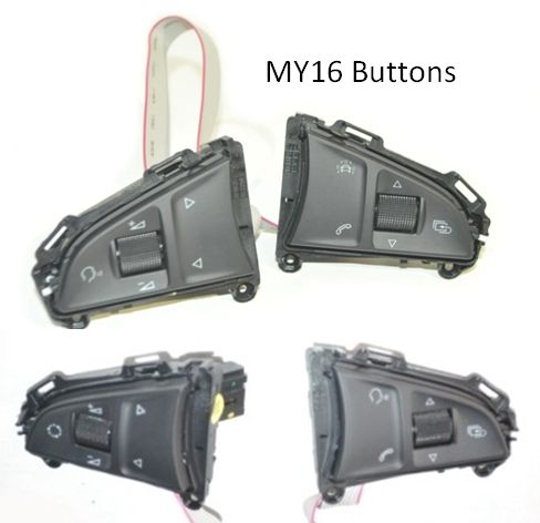

But... the buttons are not for MY16, they are for earlier cars:
119
So will that mean that that pressing 'Audio Source' will actually activate 'Voice Control' or will the buttons be correct?
Currently there is quite a big saving if you don't go the MY16 button route (plus more 2nd hand pre-MY16 ones are available etc etc)
