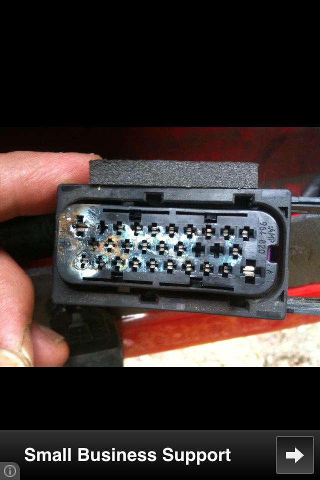

Check out the large connector in the drivers door, it's a known weak point for moisture ingress which causes corrosion & in some cases broken pins. Will cause most of the problems you have described.

Yes take the door card off & you'll see the connector. You should also check the wiring where it enters the door from the A pillar as it's very common for wires to break inside the rubber shroud.
You'll be looking for something like this..can plainly see the corrosion caused by the water ingress
Well its deffo the box in the drivers door...
I have the panel mostly off the door and as I was even touching the box the doors started going... then the windows went back up (after opening earlier today, luckily first dry day in ages) Right now just trying to figure out how the hell to get the plug bit out... seems quite stiff.
EDIT: pried the latch back using a screwdriver handle as a level... pulled down plug... water poured out... problem identified.

Well managed to clean the connections and dry it all out sprayed with silicone grease etc...
The windows now all work and the locks bar the drivers door works.
However I can hear the windows motors going again now.... at least its a stop gap fix... maybe that whole box unit needs to be changed.
