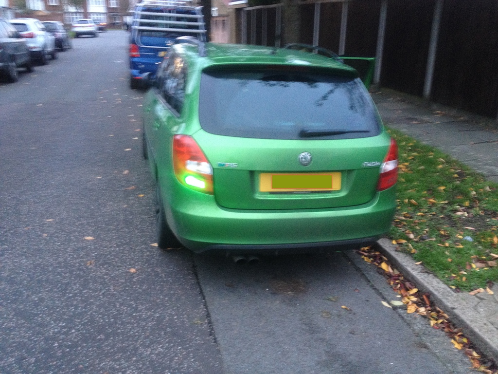

Good evening,
just been out doing some tinkering with the bulbs on the VRS. i was changing the reverse bulb to a LED one. i noticed that the LED bulb was constantly flickering? even when not in reverse and even with ignition off! i tested with a volt meter and got 4.5 V constantly. do you guys know anything about this, is it something to do with alarm or immobiliser etc? or do i just have a fault ?

the old bulb worked fine. the new bulb is made for auto 12v, its not the bulb its just that the live terminal is giving 4.5v and as the leds have less drag they light up at the lower voltage and the filament bulb didn't.
