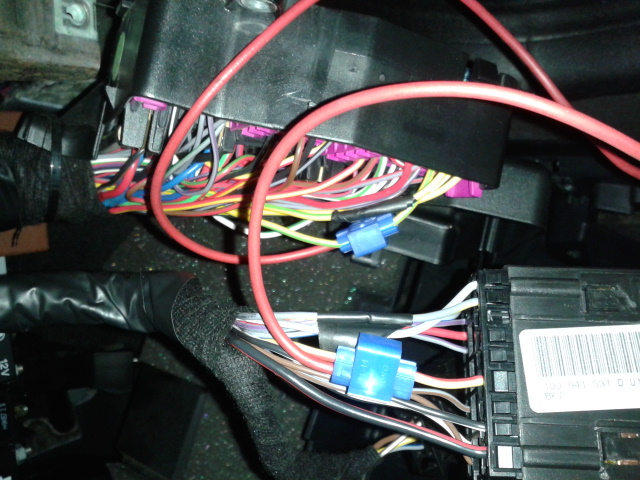

All sorted heres a pic
its pin 4 of the side light, dip beam switch to the green yellow wire of the fuse box
Ugh Scotchlocks! :peek:
Hope you aren't leaving it like that.
How's it going with the levelling motors? - have you got to that bit yet
Not yet hopefuly next weekend :)
Nope the scotchlocks were for test purposes and will be soldered :)
