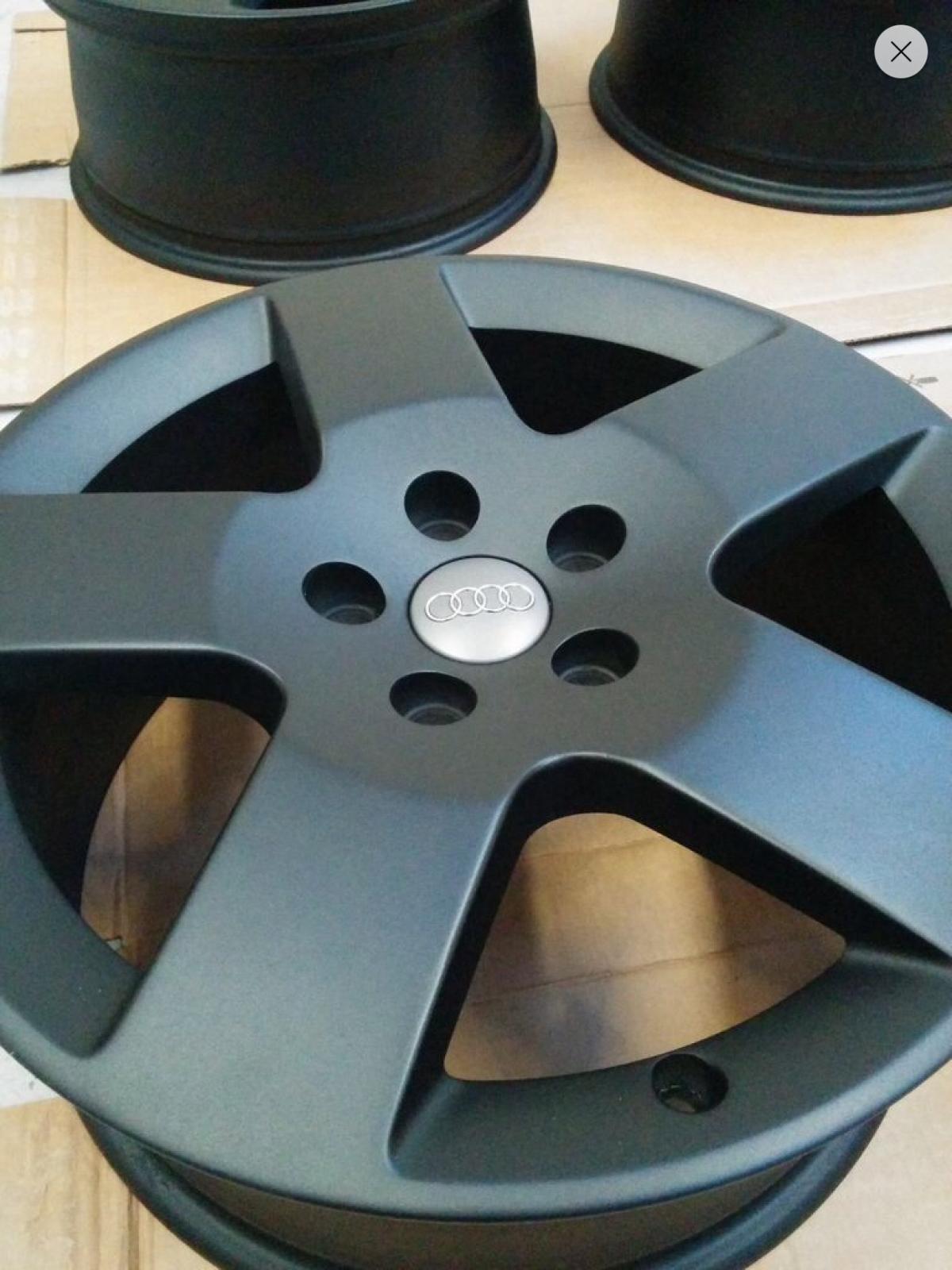

I'll have a search for the NQSBBK and also for octy's with ET56 wheels. These are the wheels I'm hoping to fit, see attached.
The spoke shape and profile do appear to be more outward so hoping that even with the wheels being tucked further into the arch then the OEM 18" Zenith's, I'd clear the Porsche calipers should I go that route in the future.

Whatever Skoda fitted wheels Yeti-Man had (Neptunes?), he had about 3-4mm clearance between the spoke and the caliper.
