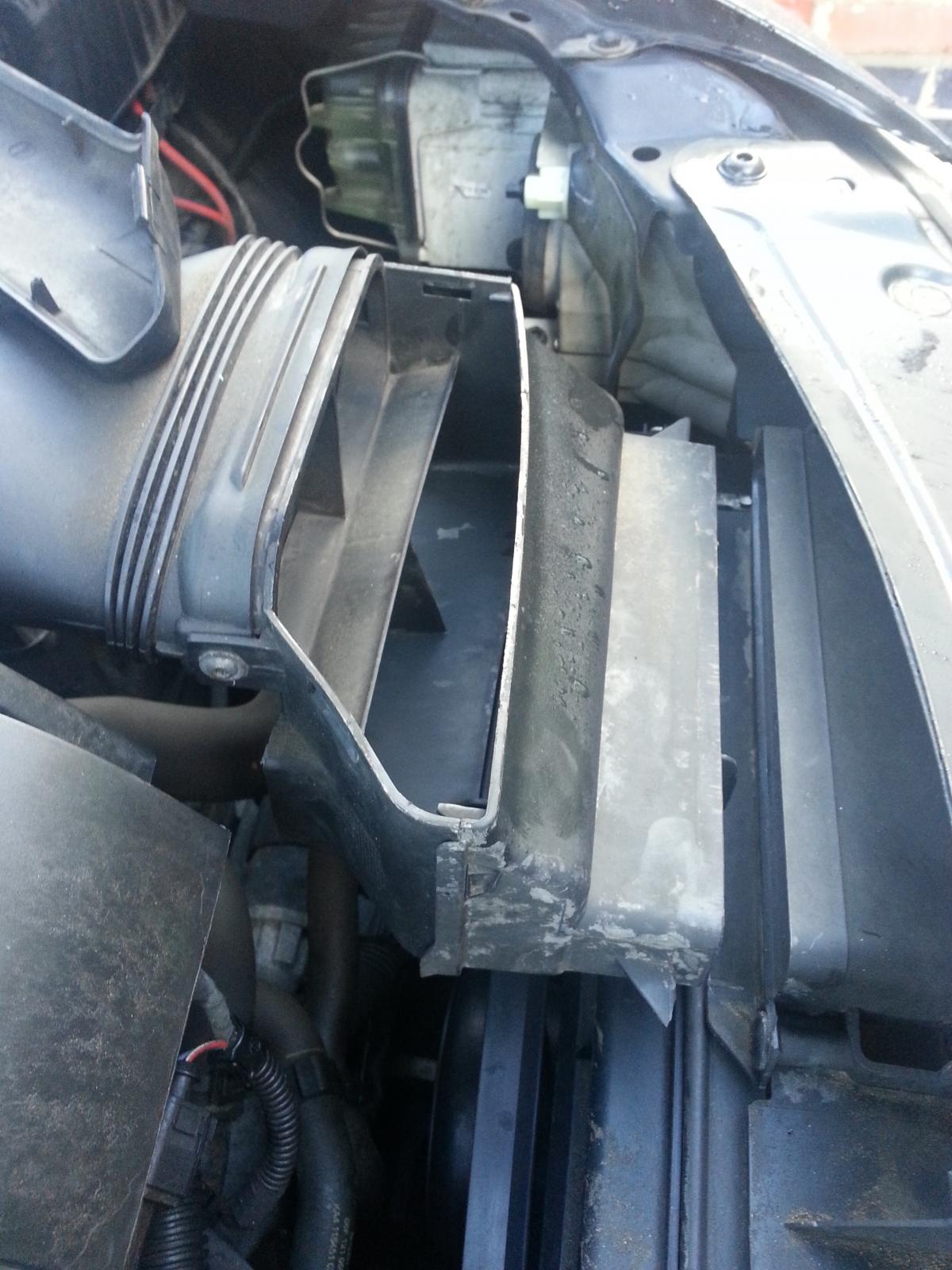

Does anybody know how the air duct (part no. 1Z0121285D) comes out?
It is the horizontal plastic part that runs over top of the radiator pack and sort of beneath the bonnet release. There are two torx screws in the centre but these don't appear to release it. Does something else need to come off as well?
You'll see from the attached picture that my intake has self destructed and broken off the plastic securing tabs to the above part, hence the need for replacement.
The tabs on mine broke when I was working on it in sub zero temperatures, old and brittle.
I just drilled small holes above where the tabs used to be in the upper part and secured it to the bottom part with zip ties.
It's nothing critical in the way of leaks, being upstream of the filter, it just channels cool air in and by way of a swirl design loses dust in the process, just check how often the filter is recommended to be changed and/or check how clean it is in comparison to other cars you've owned.

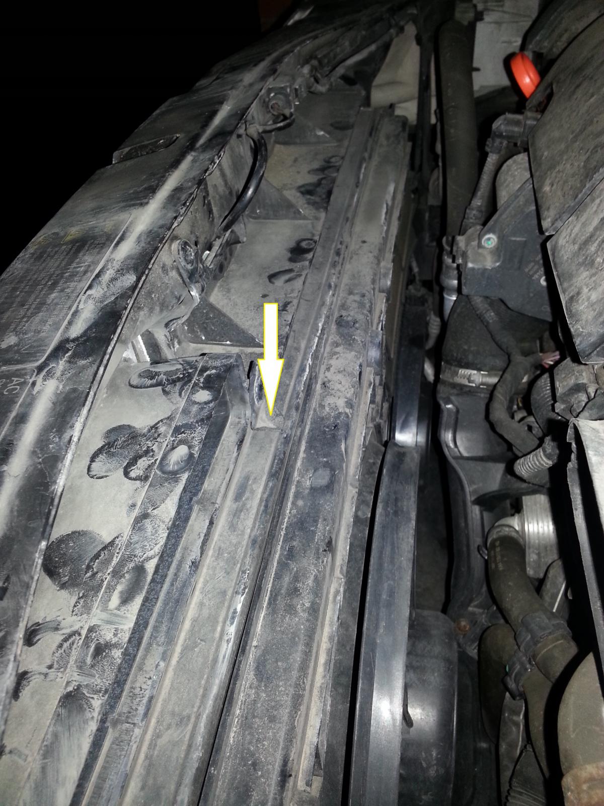

Just for clarity, the part I am referring to is arrowed in the attached picture. I'm sure this isn't the bit others are loosing  :)
Ah the part ive lost is on the left of your arrow it bolts to the part you need. :)
