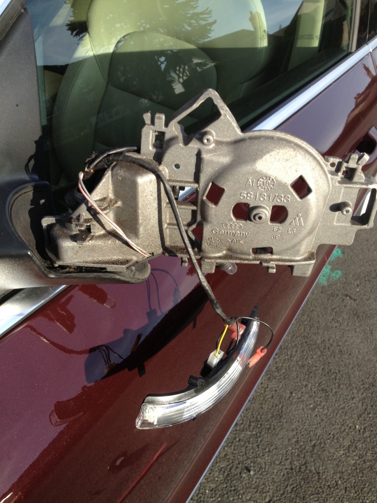

If it is like the Octavia you gave to replace the whole light unit, the LEDs are not replaceable. Any sign of water ingress? I clobbered the drivers side mirror and it split open on the leading edge and water got in.
The light unit should have the part number on it. You should be able to get a cheap replacement on eBay.

Had my car in the garage and they tried a new RH door mirror indicator LED unit and it didn't light either...
It worked intermittently but for the last few days is totally gone. All the other indicator lights work fine...

My guess is two unrelated issues, the first being due to a broken connection in the rear window element (which can usually be fixed with special paint) and the second a loose wire to the mirror from the door controller. The wires could easily be checked first for voltage, then if necessary for breaks/dodgy connections.
Also a VCDS scan should show something on these faults - have you actually seen a clear scan? If I am right with the cause, VCDS should certainly show up on the intermittent mirror indicator (as it keeps a record of faults as they occur) but maybe if its a loose but not a broken wire and (this is a guess) the dealer software doesn't record, then perhaps it would only reveal a fault if it was actually occurring at time of the scan.

The guy did mention that the lock on the connector wasn't properly engaged but ensured that he engaged it properly and still didn't work.
Is there any chance that the LEDs would not work until the car had key removed from ignition ???
If it's anything like the under-door puddle lights, then yes: you have to lock/unlock the car before it will send voltage to the bulb. That's what I found when I was swapping the incandescent bulbs for LEDs anyway. Which I thought was strange at the time.
