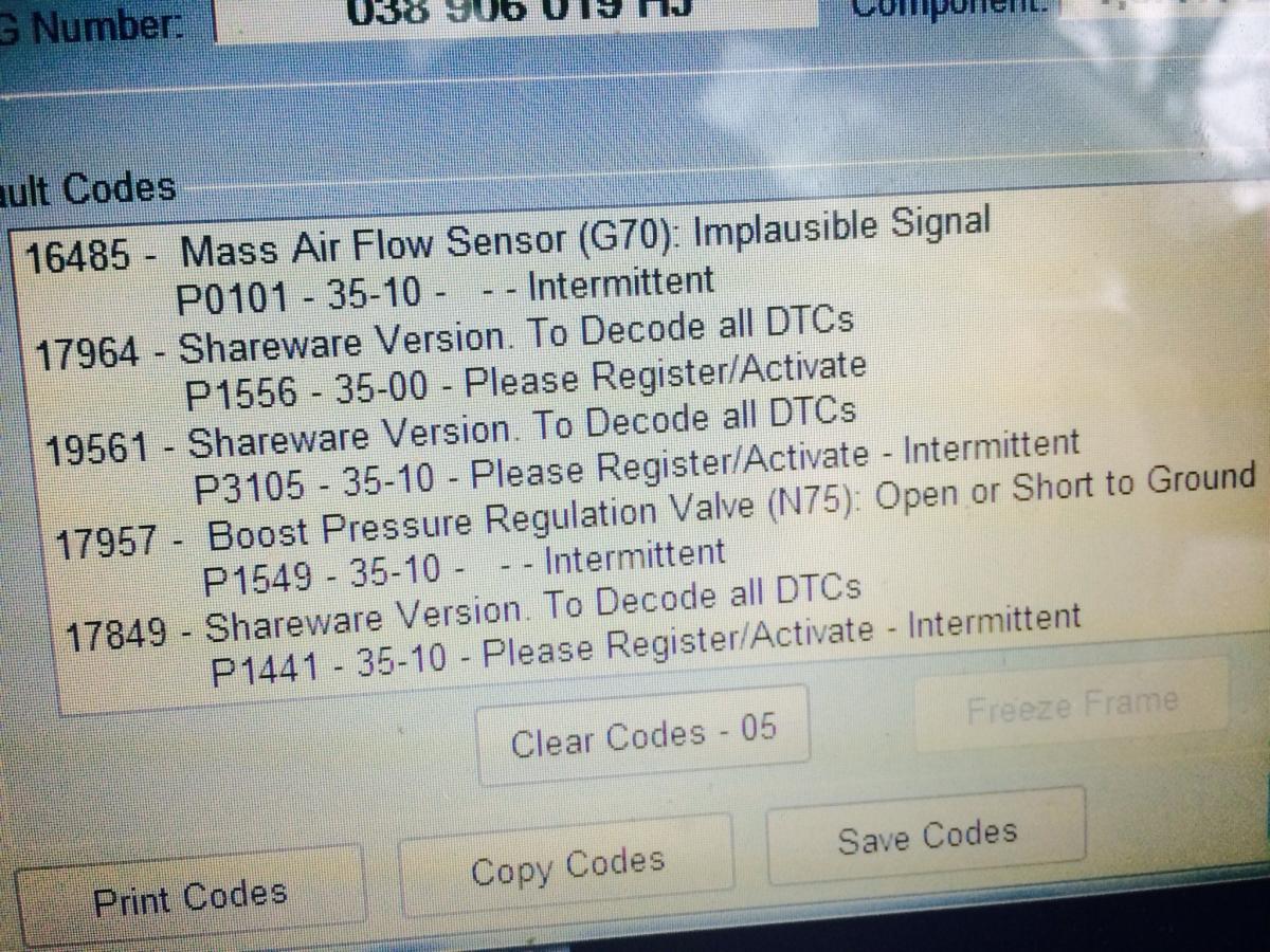

Plugged it in and got these codes. I've cleared them though and gone for a drive and they haven't come back and it's doing the same thing. Getting a bit of black smoke out the back as well.
Black smoke usually indicates over-fuelling.
  1. Check that you've re-assembled the turbo-intercooler-manifold pipework correctly with no leaks.
  2. VNT may be stuck in a "low boost" position, particularly if the smoke clears at higher revs and you get decent power once the car's "wound up".
do proper boost logs and basic settings test for boost pressure control and post them here so we can see what is going on there...
