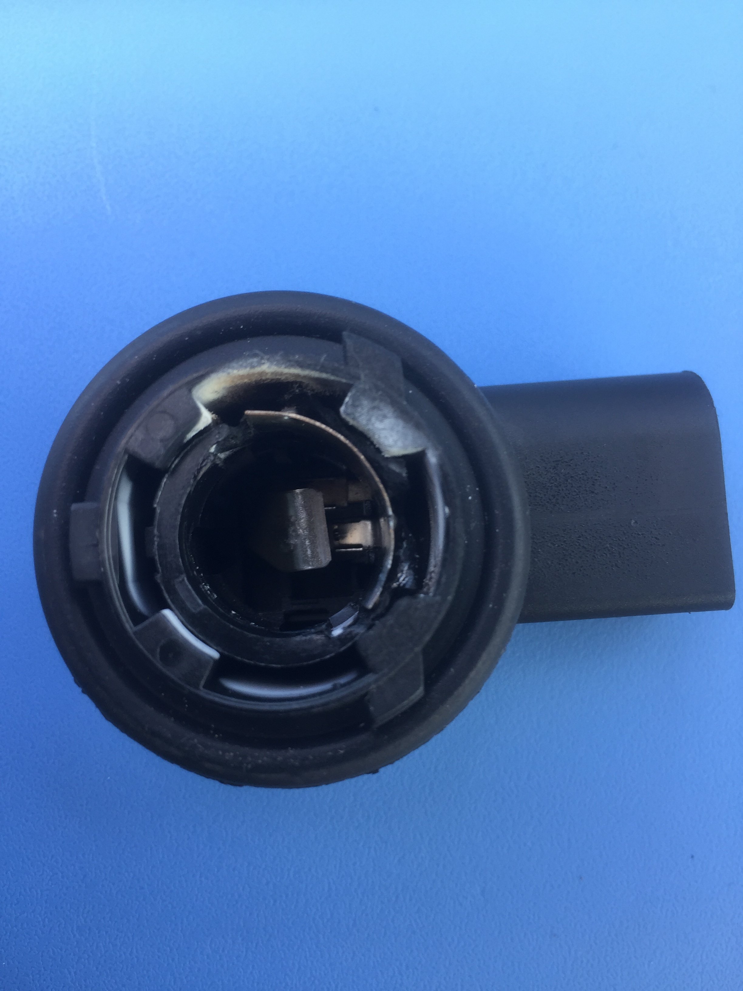

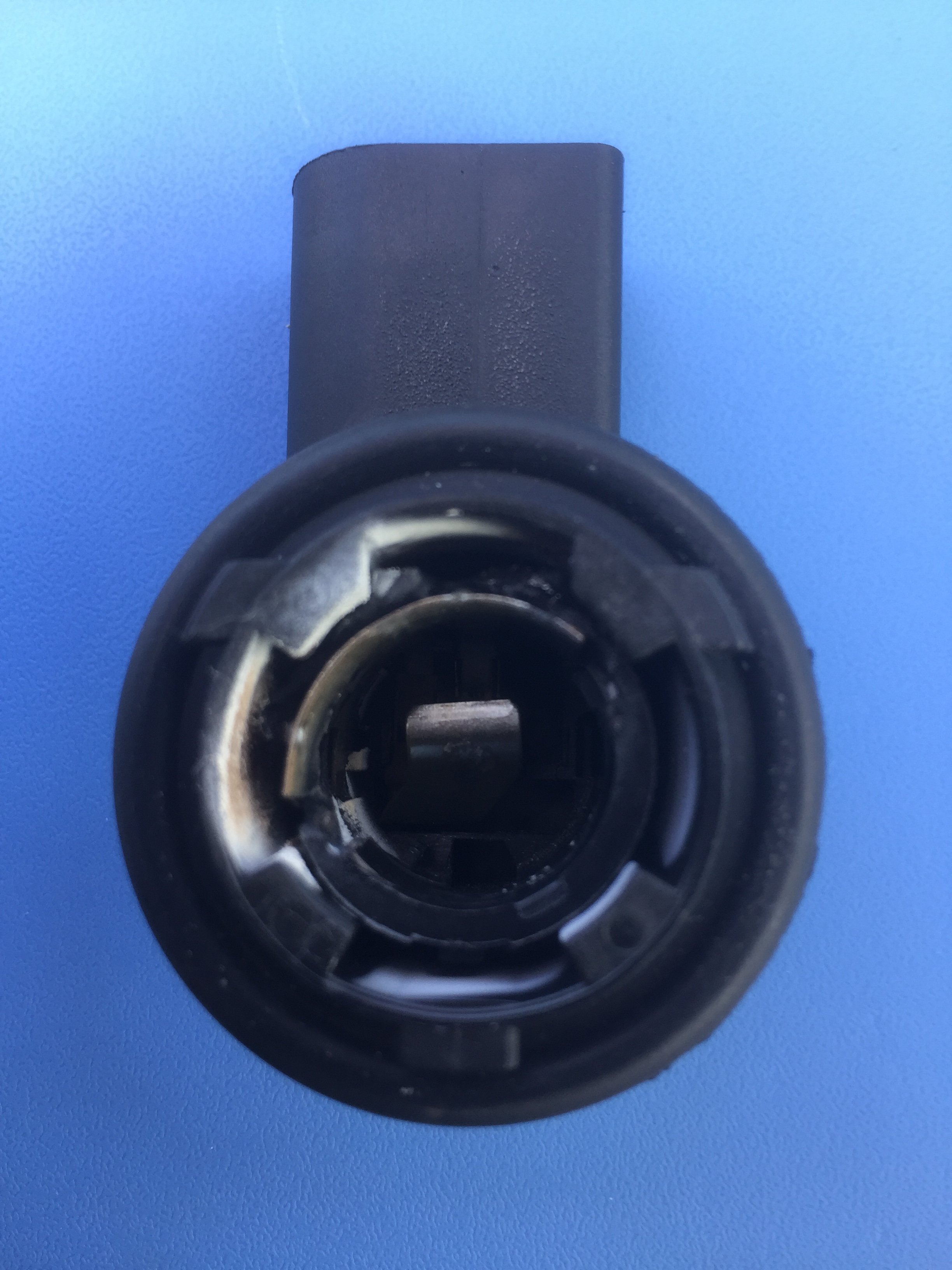

Hopefully just to aid any owner. If you are having grief with these bulbs also check the actual bulb holder as these melt and may cause the fuse to blow. These are constantly on but some models have the option to be switched off. A dealer technician decided to just change the bulb on mine only for the fault to flash up on the dash and on discovery in seeing moisture in the lens. I investigated and due to the seal being distorted due to excessive heat thus letting in water I dismantled myself and replaced the unit and bulb. Dried out the lens now all ok. Attention to detail with stealers and thier 'fully trained' 'technicians' worries me as the new bulb fitted was destroyed.
