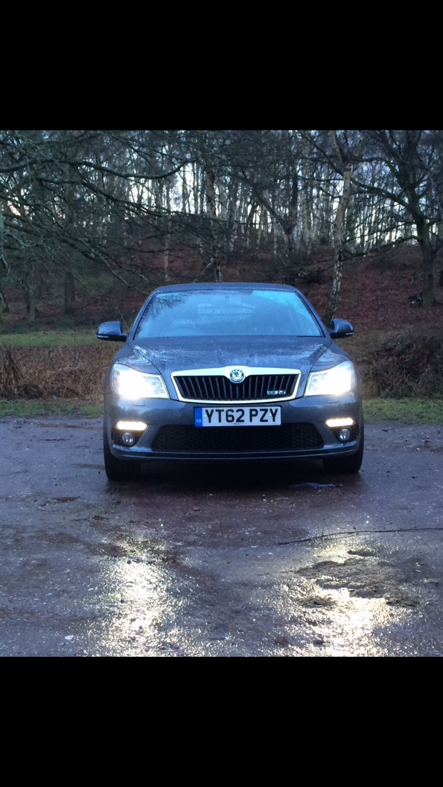

my Octavia 62 plate has Xenon headlights, however the main beam is a yellow colour and ideally id like them to match.
Also, the side lights don't seem to come on at all.
There are little blue bulbs in the side light places, but when I flick the sidelights on onthe dash, nothing comes on.
My question is.... Can I change the main beams to a 4300k white?
Should I have side lights that work as Skoda man said the side lights are the LED running lights (although when I had my previous non xenon octavia, I had side lights as well as LED runners)
Anyone with Xenons on a VRS shed any light (pun intended)

My Xenons are standard as far as I can tell, they self level dance at the start and have the body coded washers that come out of the bumper.... The dipped beam is the nice white twinkly colour, but the main beam seems to be another bulb and it's more of a yellow tinge.....
I just wanted that one to match the White of the dipped beam... If I make sense?

I have exactly the same setup as you Anthony83. OEM Xenon dipped projector lamps with auto levelling and washers. A kind member on here advised (similar to above) that a HID kit for main beam is pretty pointless due to the warming up and on/off scenario when flashing/signalling etc. Let's face it, it's purely cosmetic. I'm not knocking you as I thought the same when I stood back from my Octy with the main beam (use it to put her in garage as it's a tight squeeze) and noticed the distinct 'yellow' tint.
