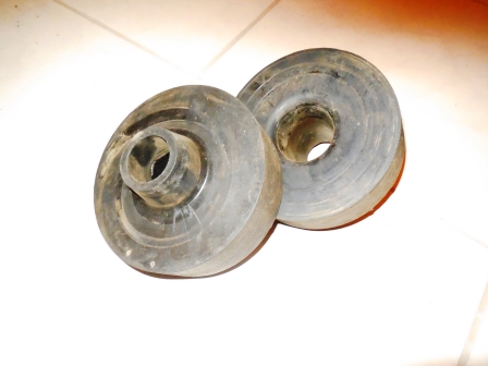

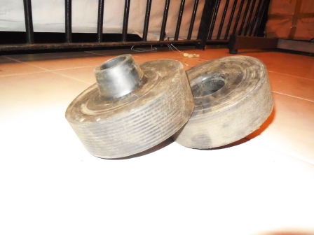

Great, before fitting have sth available to cut them a little bit, in case the car is raised too much. These are the ones I ordered (unfortunately 30mm).
Just make sure you find someone to fit them without removing everything back there. You will need the special vag spring compressor tool.

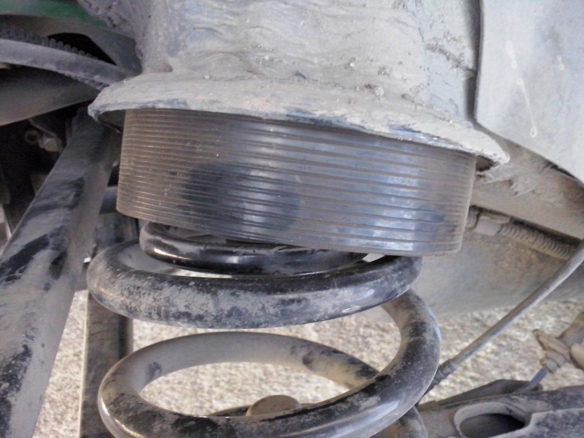

Just found some pics after installation:
Thx for the pix! :)

and also, this may sound like a stupid question but what is a sth? Will have to cut them down a bit, looking a bit crammed there on your pic of the rear :)

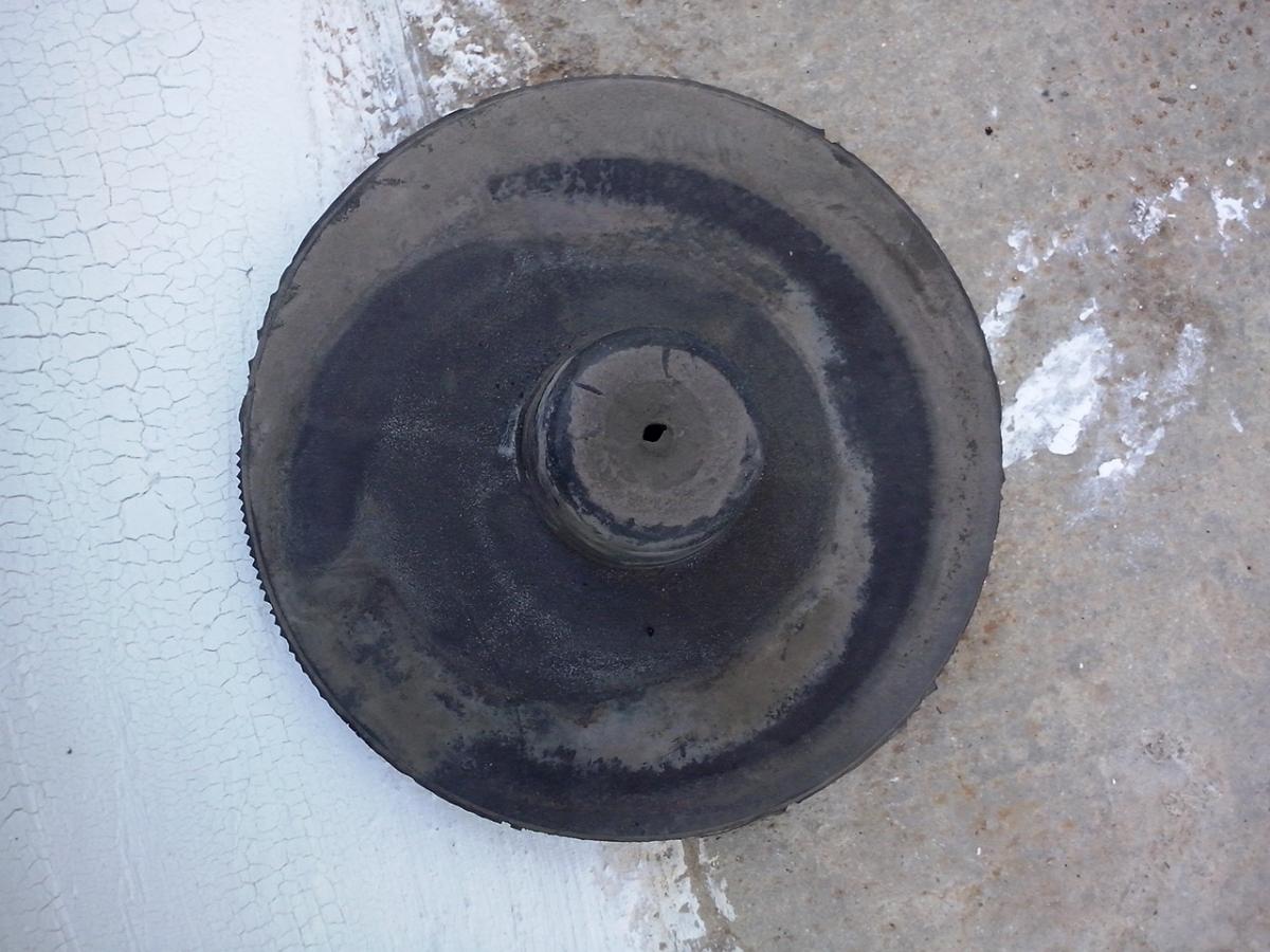

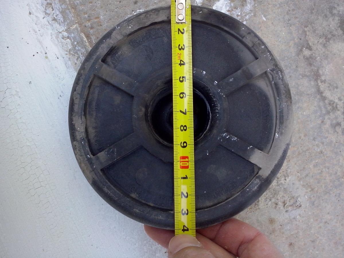

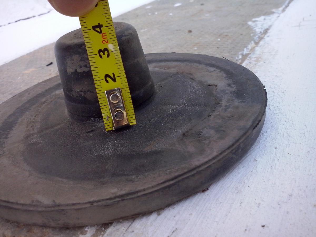

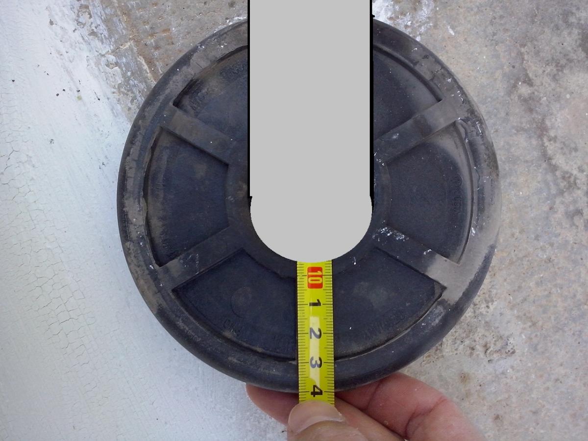

I can give you another solution. In the pictures 1-3 you can see the original spacer. What you can do is to make a home-made spacer like the one at the photo 4, no more than 1.5cm. Then try to compress the springs with your car raised and, if the gap at the arrow is enough, insert the home-made spacer above the original.
That sounds even better! :D  I've read somewhere that peple raise cars with hockey pucks, tough that's frame raise on 4x4 trucks, not suspension raise. Any idea where I could use that could take the beating, or could I just get a couple hockey pucks and use a "pneumatic milling machine" (sry not sure if it's the correct english word) and cut it to size. Thanks again for takong the time to post pictures, its a great help as I haven't had the car for more than 6 months, so I'm not yet completely familiar with its construction :p
