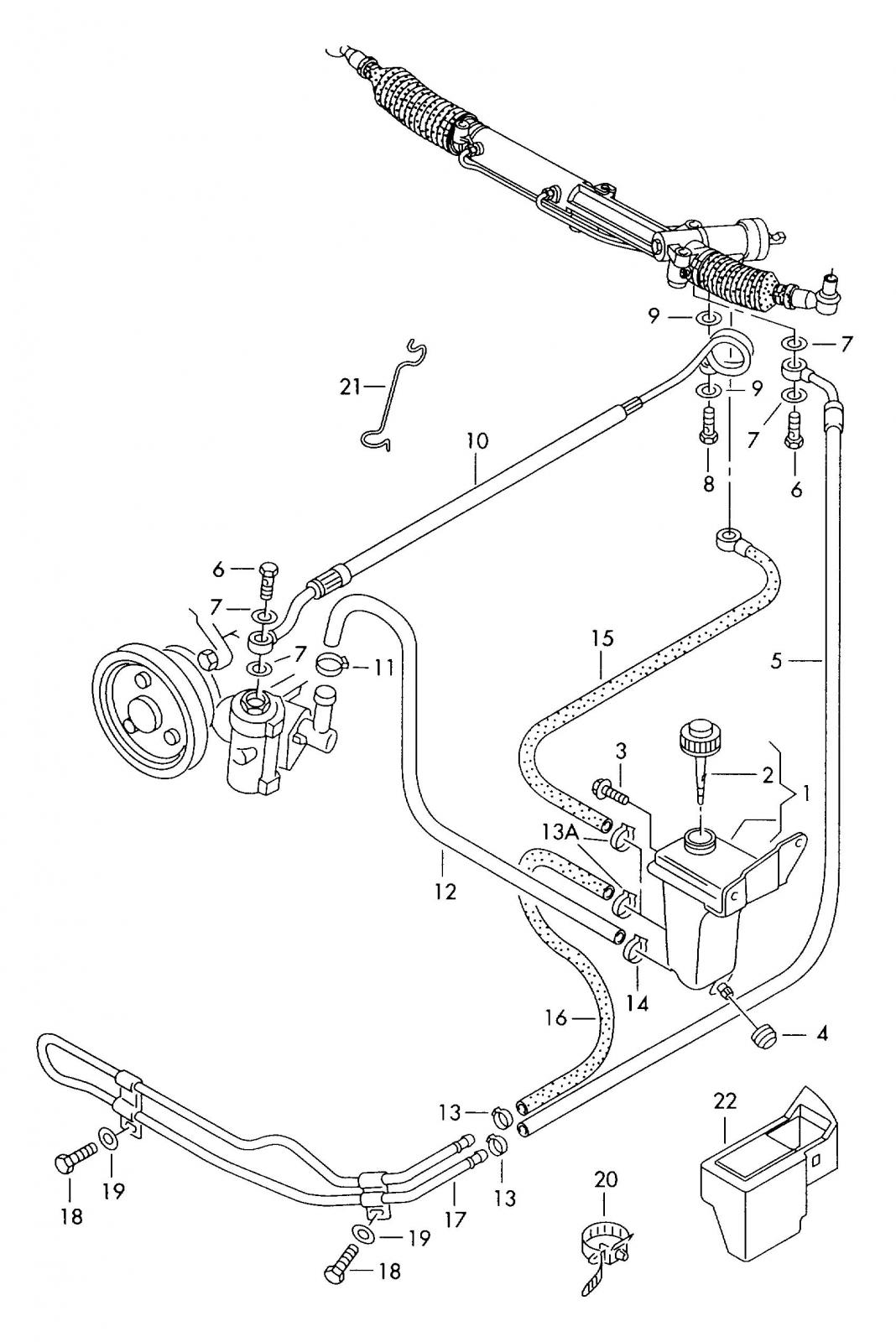

I will post below the schematics of the hydraulic steering circuit and I can identify for you items 5 and 10 (replaced due to leakage in my car):
 - no 10 is part number 3B1422893C - the flexible hose from vane pump to steering rack (this was very expensive ~ 300 Euro, due to the metallic/rubber insertions and serpentine cooling)
 - no 5 is part number 8D1422891T - the cooling return hose from steering rack to oil container
My understanding is that you are looking for part 10 in the drawing. Is this correct? If so, this would be quite some work to change, as you need access to the steering rack and this is located above the gear box. I changed this hose at the same time with the clutch kit.

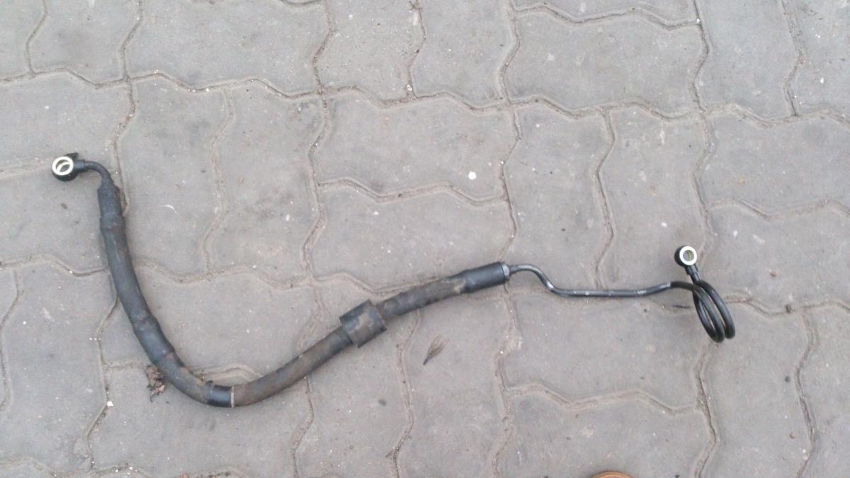

The reason of that part in particular(3B1422893C) being so bloody expensive is that you'll not find it elsewhere besides the dealer (at least here I didn't) and I would not recommend to get a used part, due to the high working pressures and difficult access to it. If it helps any further identification, see below the picture of the one I changed:
Edited by iob
Apparently its part no 10,isn't it?
Iob, the pic u posted shows a curved section at the end before the connection to the pump,mine is straight
As you can see in the circuit schematics, there are only 2 pipes connected to the pump, one rubber hose going to the oil container (part no 5) and the pipe going to the steering rack (part no 10).
Regarding the exact shape of the pipe, for sure there are some differences (due to engine displacement, size, oil pump location in the engine bay) between various engines (i.e. 2.5 tdi vs. 1.8t) - you could see from the picture of my actual pipe that it has a large bend which is not shown in the drawing. Important things are the connecting parts and the engine code giving you the correct part number, which in this case might be different than mine.
By the looks of your last picture (I can't make too much from the others) it seems that part no 10 is your leaking part, but I would ask an independent service to have a look, just to be sure. Anyway you will need them to replace it, as this is not a DYI job, due to the gear box unit.
