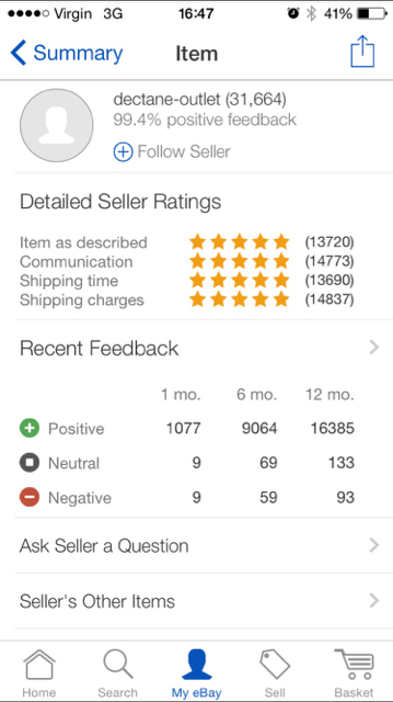

Mil7215 I see you have same age VRS as mine, did you buy from e-bay or direct from Dectane in Germany , the ones on e -bay looked like they were facelift onwards?!
Edited by Loopy1
Bought from ebay from dectane clearance. Cost about 80.00 delivered.
Ebay item no - 311244137237
