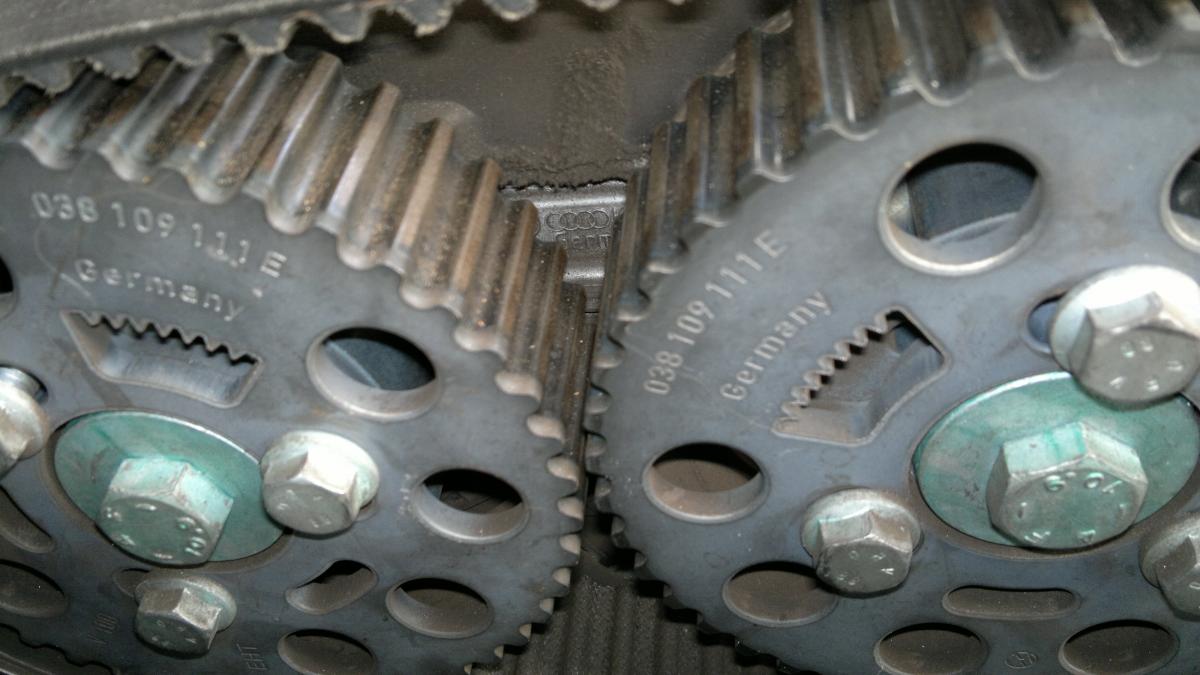

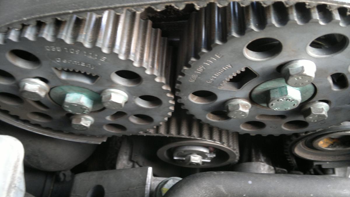

Does this look very far out?
Put it this way, both of them adjustment windows should be at 12'o clock
