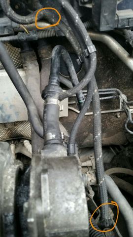

I did the Mr muscle turbo clean last weekend and upon putting everything back together I have this stray hose that just dangles there seemingly with nothing to connect to. [emoji35]
post-127511-1425123993009_thumb.jpgThe car starts and drives ok and if I put my finger over the end of the hose it feels like is sucking air in....
Oh it's a mk1 octavia estate 1.9tdi.
Does it not go to the airbox?
I would imagine it is the return feed to the airbox from the valves on the bulk head)
This diagram might help (see the stuff in yellow)
Yep it goes in the airbox, thanks for that.
