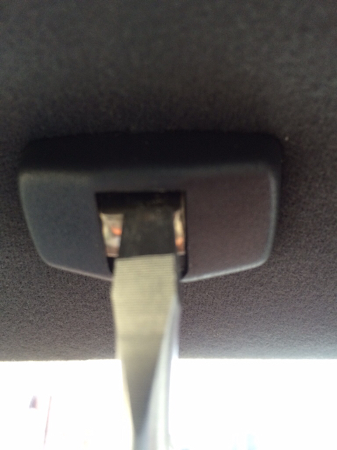

Working from the drivers seat side of the clip and not window side...
Take large screw driver and slide as shown below.post-64246-14261716229139_thumb.jpg

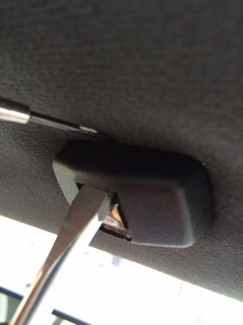

Next take small screwdriver and press in slightly along roof line. In one motion press in and out with large screwdriver and then with smaller one try and flick the cover down. You will see it flex when you press the large screwdriver. post-64246-14261717465649_thumb.jpg

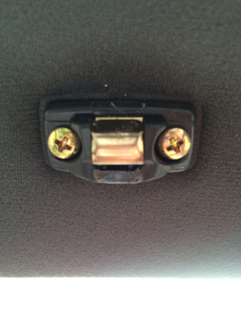

The cover will pop off easily. Leaving the screws and clip exposed. post-64246-14261717954845_thumb.jpg
Simply unscrew replace with new and then push the plastic cover back on. You will hear it click when it's home.

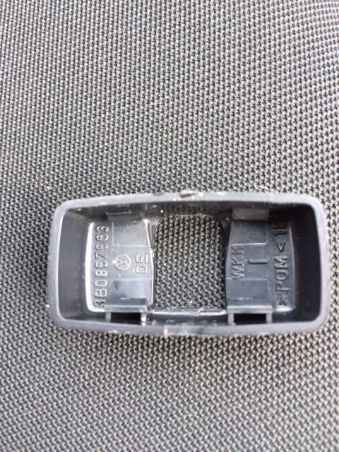

Here's the inside of the plastic cover so you can see the lugs that hold it on. post-64246-14261718843768_thumb.jpg
