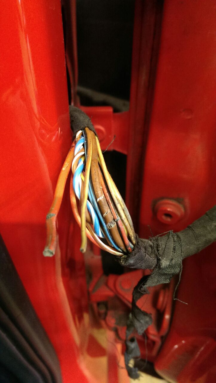

Drivers window failure.. Fixed by reading forum posts

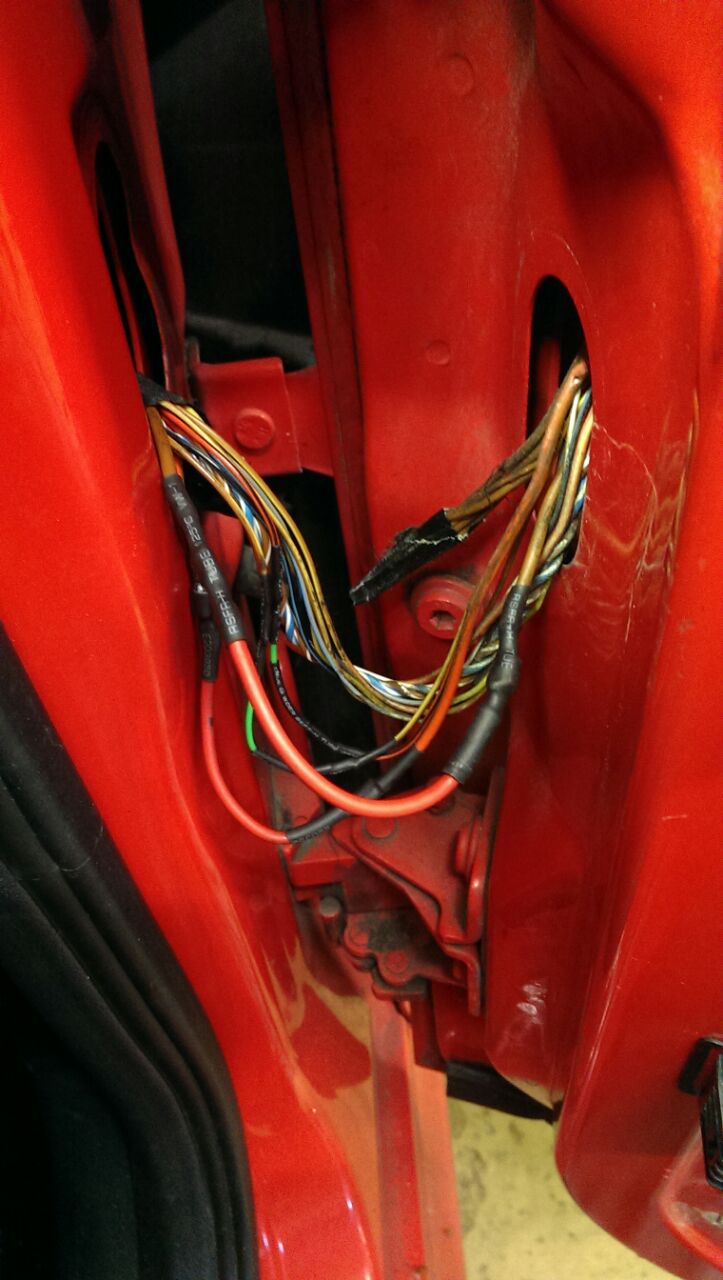

My drivers window had been playing up and finally gave up, just a click when operated. I searched the forum on the subject and turns out broken wires are a common problem. BINGO.. 2 broken and 2 more needing attention. Out with soldering iron and all sorted. Saved loads time and money by reading the posts, goes to show just how helpful this forum is so a big thank you to all who posted on the subject.post-86902-0-95298900-1426468730_thumb.jpg
