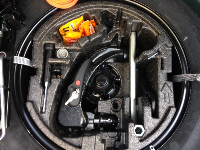

As previously mentioned, the Skoda OEM detachable bit has a storage space inside the spare wheel insert - which is quite convenient. Not sure who the manufacturer is though I'm afraid.

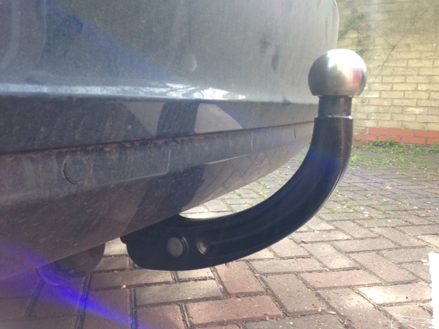

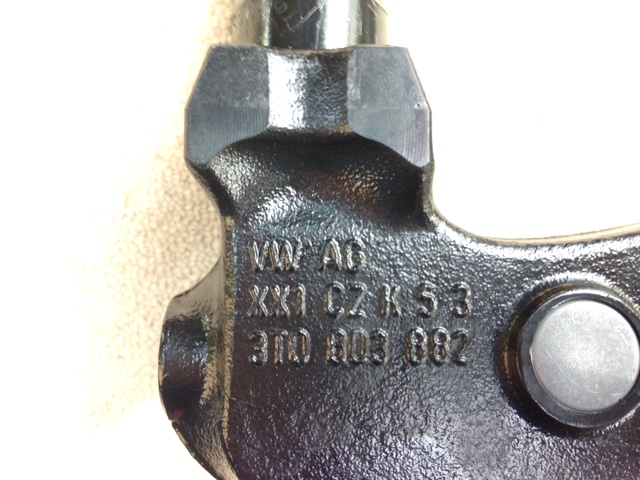

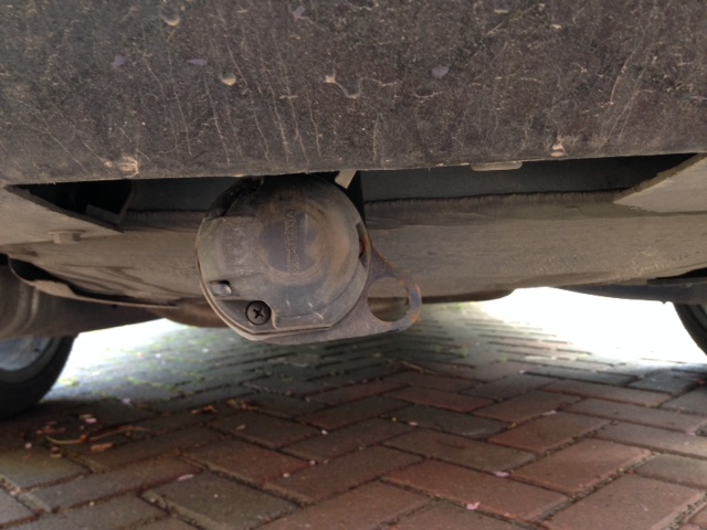

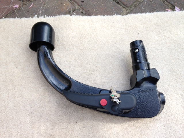

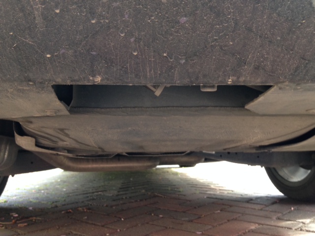

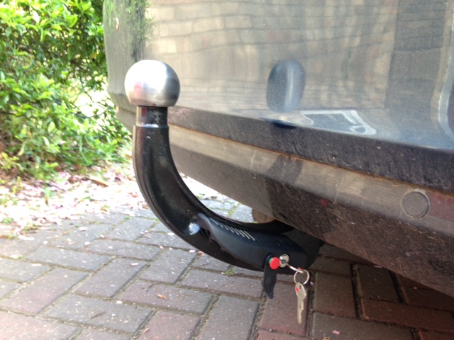

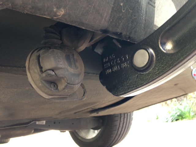

Hi Jonathan , any chance you could send me a photo with the towball fitted ?im curious to see how it looks on the car thanks
I'm pretty sure it will be westfalia , my dealer thinks so. As I haven't seen one I'm tempted to stick with the witter one I've used the quantum on the last 4 cars
It's not (so your dealer is wrong). The OEM towbar is manufactured bij Prof Svar.
Thanks. I'm pretty sure I'm going for the witter quantum Towbar anyway with skoda electrics. It looking like around £530 fitted.
Sure. Let me know if you'd like any other angles!
You can't see anything from behind unless you're on your hands and knees under the bumper itself. Interestingly the electric socket cover has Westfalia stamped on it so I assume the towball itself is the same in spite of no obvious maker's marks that I could find.
It attaches by simplying inserting and pushing upwards until the big lever clicks up where it can then be locked in place. Removal is done by simply pushing down on the big lever.

Hi Jonathan
Thanks so much for the comprehensive shots.
