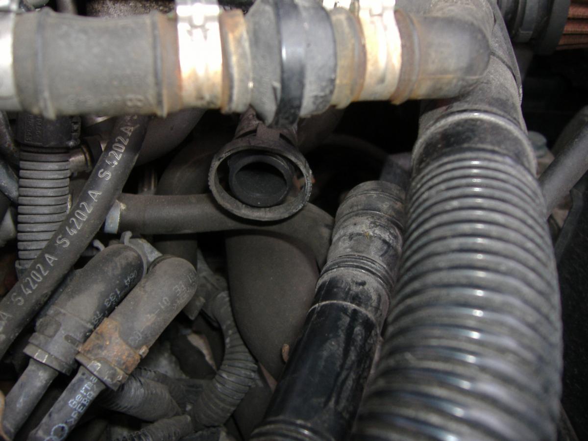

Initially, I found a pipe from the SAI pump that was loose. However, this looked like it had been disconnected for ages and my SAI pump is disabled (but accidentally re-enabled) anyway. I had a further poke around and the clip for a charge pipe from the turbo to the hard pipe before the pancake pipe had somehow migrated, leaving the rubber pipe to fend for itself, which explains the random holding of boost in some situations.
It has lasted almost a year, over 10k miles and several mapping sessions since the pipe was moved to do the manifold and actuator work. The man on spanner duty has been P45'd, i.e. me!

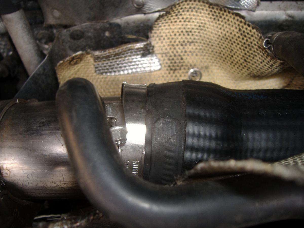

Oddly, this problem has recurred today, after a few thousand miles, towing duties and track action. It looks like the rubber pipe has deformed slightly and the clamp can slide off easily after some time, causing the boost leak. Going to try a new genuine Jubilee clip, which is pennies, to replace the Norma brand before looking into a new rubber pipe. Anyone else had this problem before?

Well, this is annoying. Pipe blew off again after a couple of hundred miles of trackcar towing duties. I've asked SFS if they can supply me with just the elbow rather than buying a whoel 5-hose kit or going for a new OEM one.
