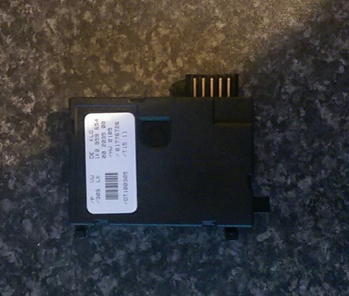

I have a known working one here off a 2006 tdi Estate part no: 1k0 959 654. Not sure if it will fit your car but you are welcome to it if it does maybe someone can advise?

I had this problem and found that some grease from the airbag slip ring had dripped down and covered the little sensor 'eyes' on the steering angle sensor. I removed the sensor, spent a few minutes cleaning it with cotton buds, put it back and it worked perfectly after that.
Big thanks to Nikonite for the free sensor, it was fitted today and has sorted the problem, my original one was the same as nick74's, my mechanic asked me if I had spilt some sort of fluid or grease as it was all over the sensor.
He dried everything and fitted the new sensor and its good as new again.
