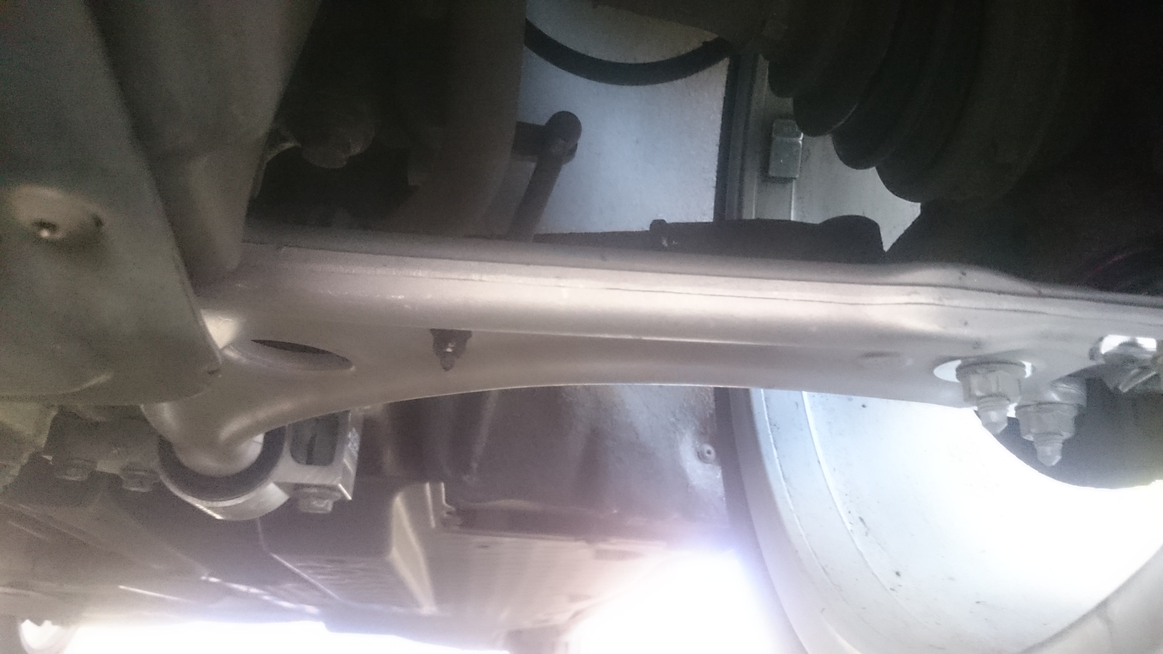

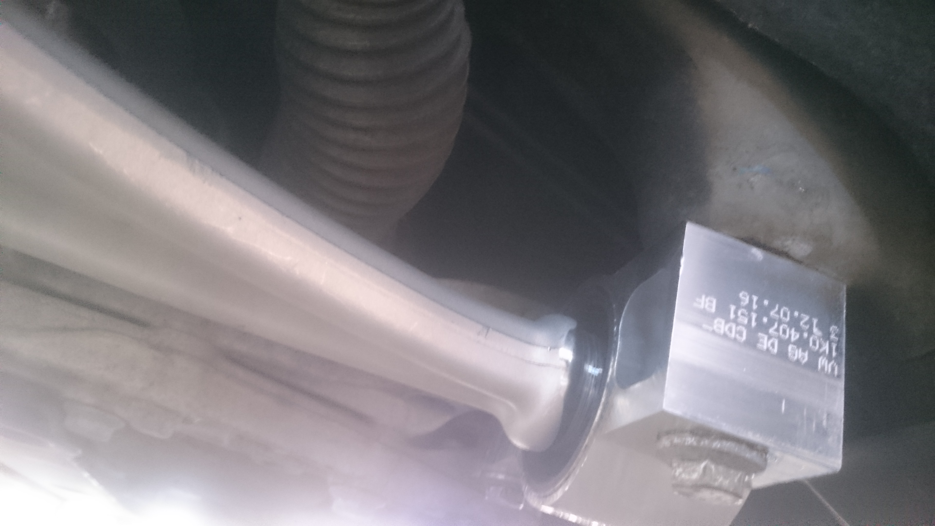

An MOT failure for control arm bushes saw the original steel arms replaced with S3 alloy items, they only weigh 1.8kg less per side but every little helps!

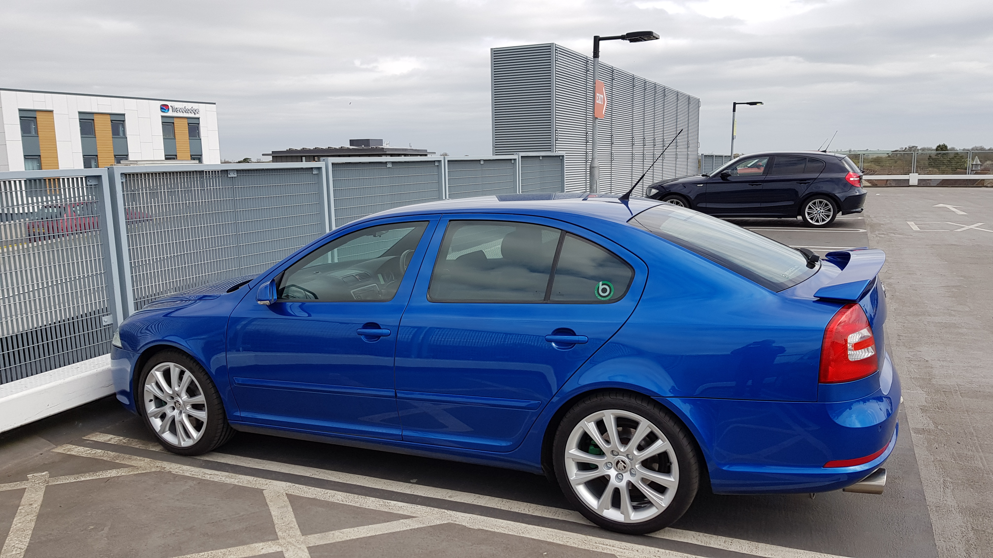

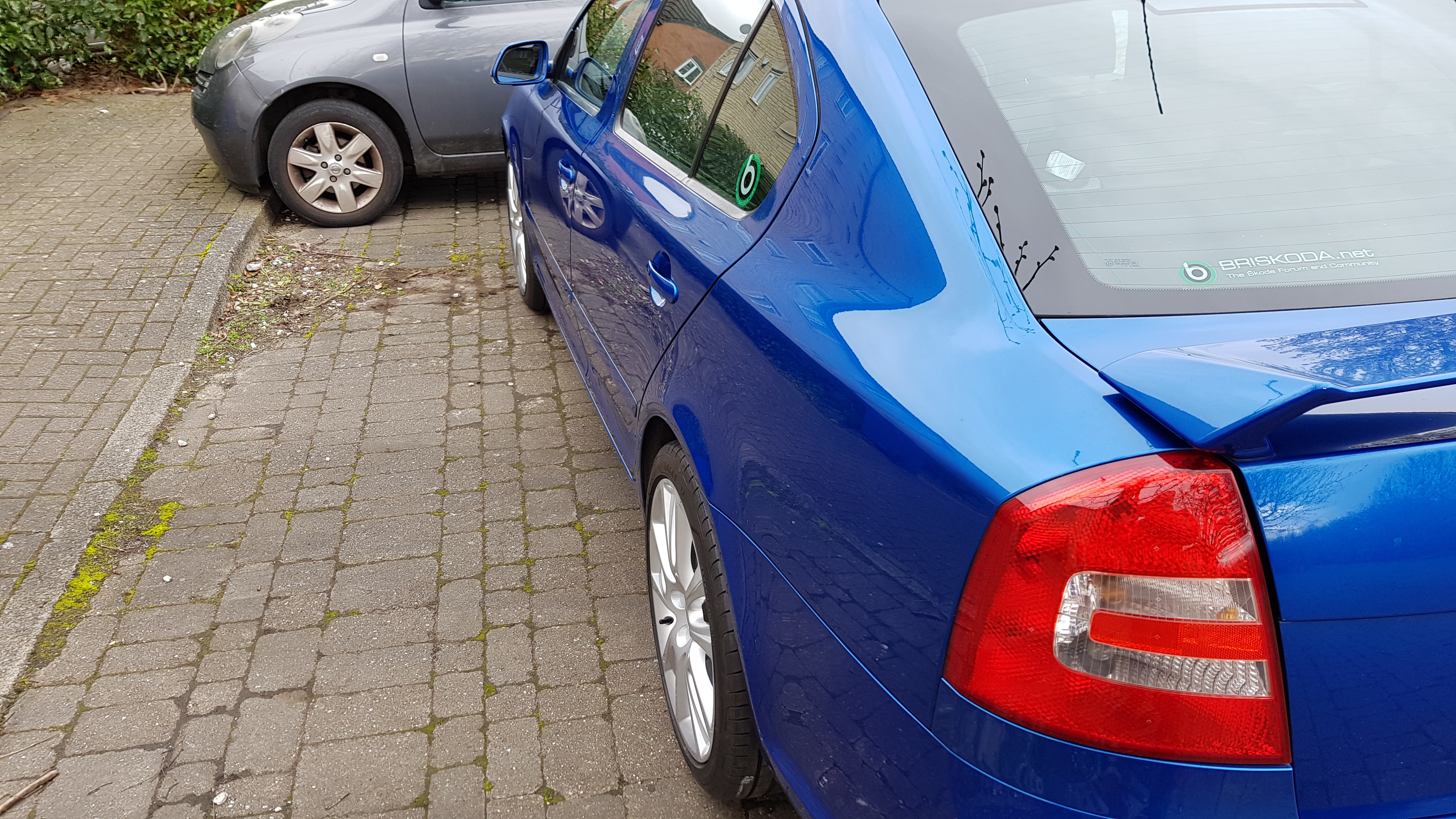

Finally got my wheels referbished and the winters off! It also now sits on new OEM dampers and Eibach -20mm springs, along with 20mm H&R spacers on the rear, IMO  just how it should have been from the factory.

What figures did the stage 1 re-map give? Guessing 250-260bhp!
I've never had it on a rolling road, but somewhere between 240 & 255 BHP.
