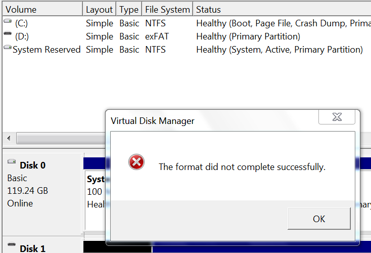

diskmanager says....

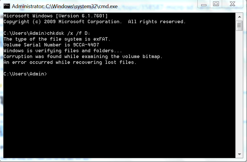

chkdsk says.......(attached file)
What say you?
