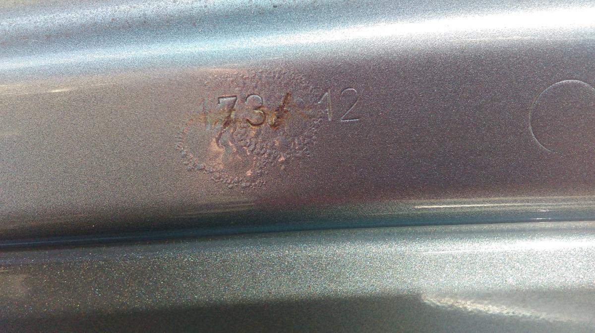

Recently found this on my Octavia Est 2012 .....on the underside of the bonnet near to the windscreen
Check your Octavia's!!
Could it be where the wiper arms have been lfited up with out being put into the park position?
Looks like maybe the stamping for the part has stopped the paint filling properly. It's well away from any chance of stone chips so you should be making an enquiry about claiming the anti-corrosion warranty.
Otherwise since it's out of sight I'd probably be smearing some nice thick grease over it.
No this is where the body work has not been correctly treated, nothing to do with the wipers.
Beaten to it as was about to say it looks like it may be due to stamping of the numbers. I checked mine and no numbers stamped into the panel BUT  I found two rust marks in the about the same place, each about 2-3 mm diameter which like they have been made by being in contact with something in the past - factory tools for lifting?

I have an appointment with the local Skoda garage body shop on Friday so they can measure the paint thickness and prepare a report for Skoda UK.
The Service Manger took a look and said this is the second one he has seen in that position. The first claim was rejected by Skoda UK as they said the seal had been rubbing against the bonnet and the supplying dealer should have adjusted the bonnet. The seal is so compliant I doubt anyone would have considered adjusting the bonnet at PDI.
No rust at the front edge as shown above.
Sorry for hijacking the thread. I will start a new one if you like.
Update: I photographed my two rust spots on the bonnet and then enlarged the photos to see more easily.
One of the rust spots is exactly the same location and from the number stamping as shown in photo in post number one. The difference is I caught it early thanks to this thread and the rust is not so extensive.
