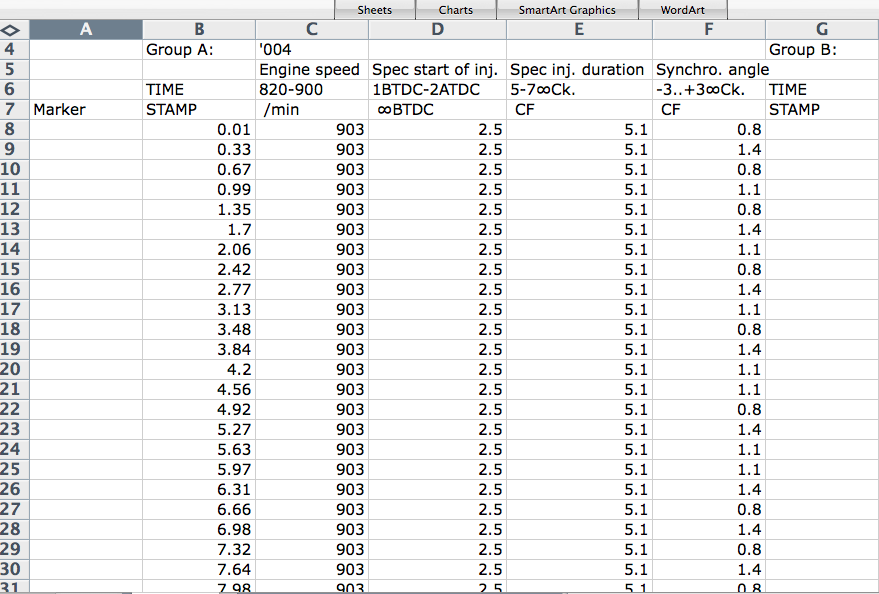

Ive got a terrible starting issue, and a slightly lumpy idle, plus some smoke.
I checked the timing today to see what the torsion value was and did a log.
Obviosuly i want to get the timing as close to 0.0 as possible, but wondered if it was normal for the value to fluctuate.
Mine does so between 0.8 1.1 1.4
Ive attached a pic of the data log which has the torsion value on it, also the smooth idle injection data.
Is that normal?
thanks :)
Never mind, I've adjusted the timing, it's now between 0.0 and 0.3. As close as I could get it.
