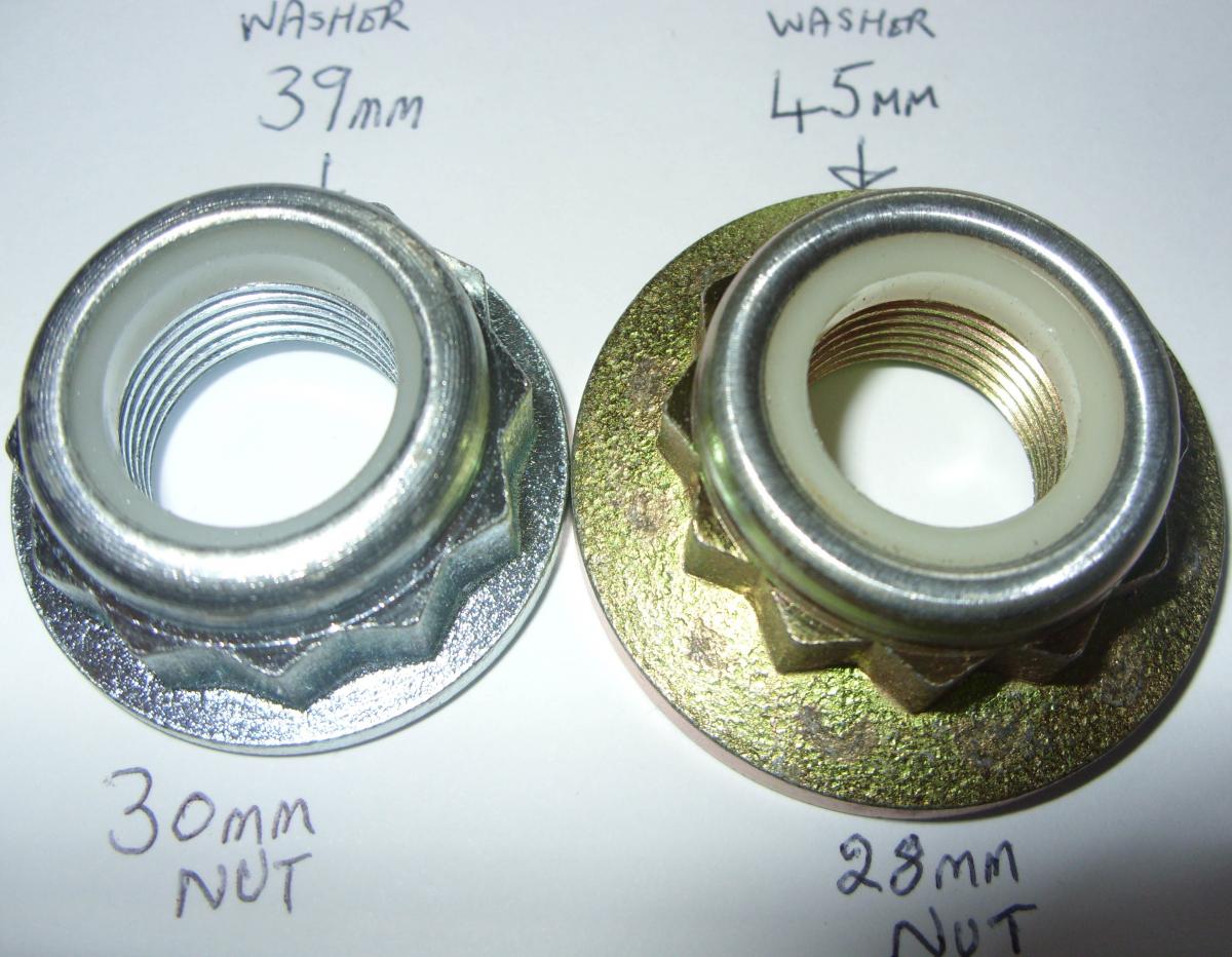

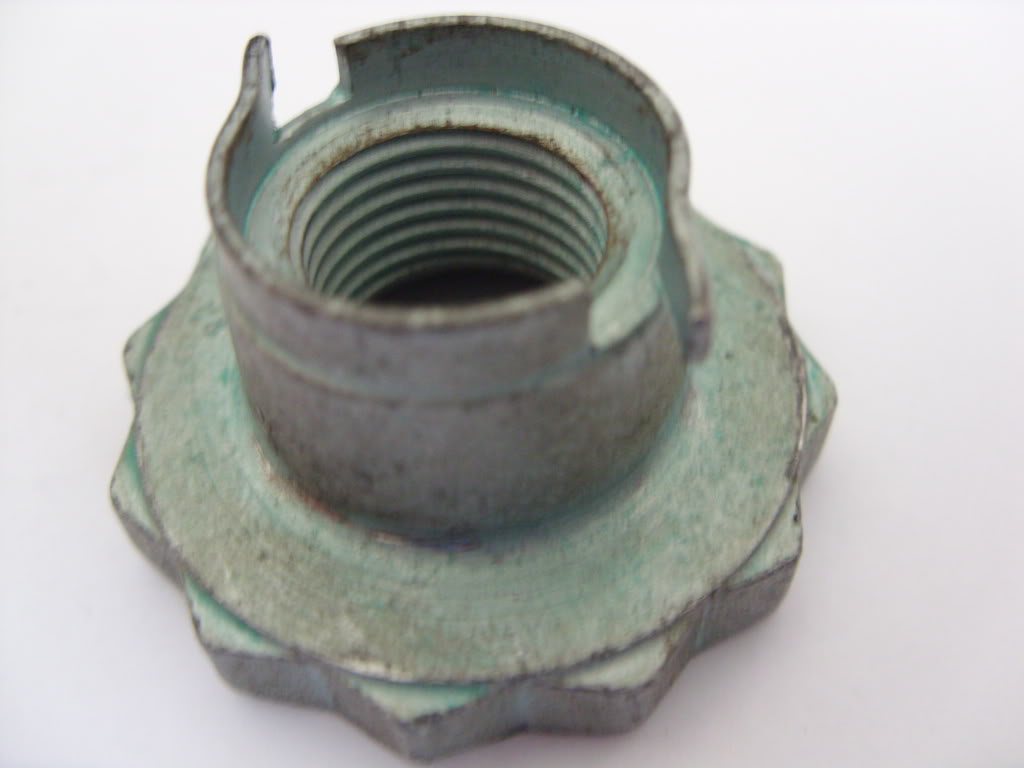

Does it look like this? my 2005 Fabia VRS..
If so, on front hub you need a thin walled 36mm socket..
Rear hub similar but different size, if I remember correctly..
What I got from ebay was a Bergen    "5pc 1/2 " drive triple square Bit Socket Set . "  It has a set of drives from M10 to M18 . The M18 size fitted the rear hub bolt of my 06 1.9 d elegance
As brad said it has 12 points
Edited by erindad
Front is either a 30mm 12 point socket or 36mm 12 point socket. Just had same issue trying to get one of an ibiza.
I' never took a photo as I didn't have my phone at the time but it's not a socket needed, it's a m18 splined bit. As pics above show nut it's like inverted
