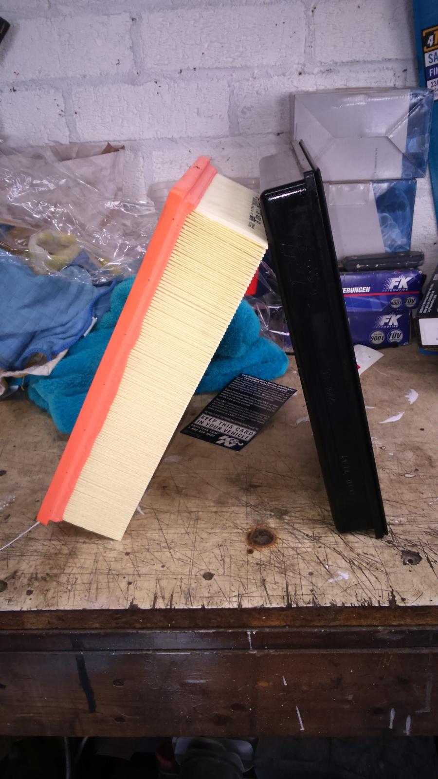

I have a K&N panel filter in mine which has made an improvement.
You can understand why when you see the depth of the standard paper element and the plastic noise reducer/ snow catcher in the bottom of the airbox!
Standard filter/K&N

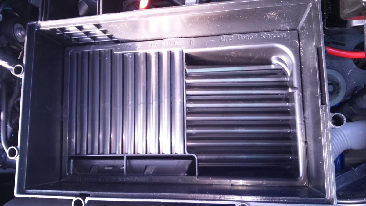

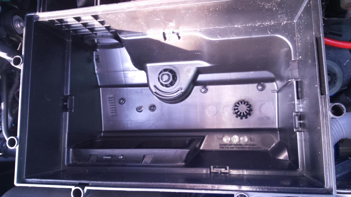

Noise reduction/snow catcher (someone elses name for it not mine)
Removed
The "noise reducer" is also an airflow guide.  Removing it entirely might not be the best idea.
On my Octy2 I modified mine by removing every 2nd rib

Just remember you can't remap to 300bhp without any change in air filter... What makes you think it's restricting performance at 220bhp? The bigger standard filter means it has more surface area to filter and let air through than your aftermarket filter? More surface area is a good thing on an air filter!
