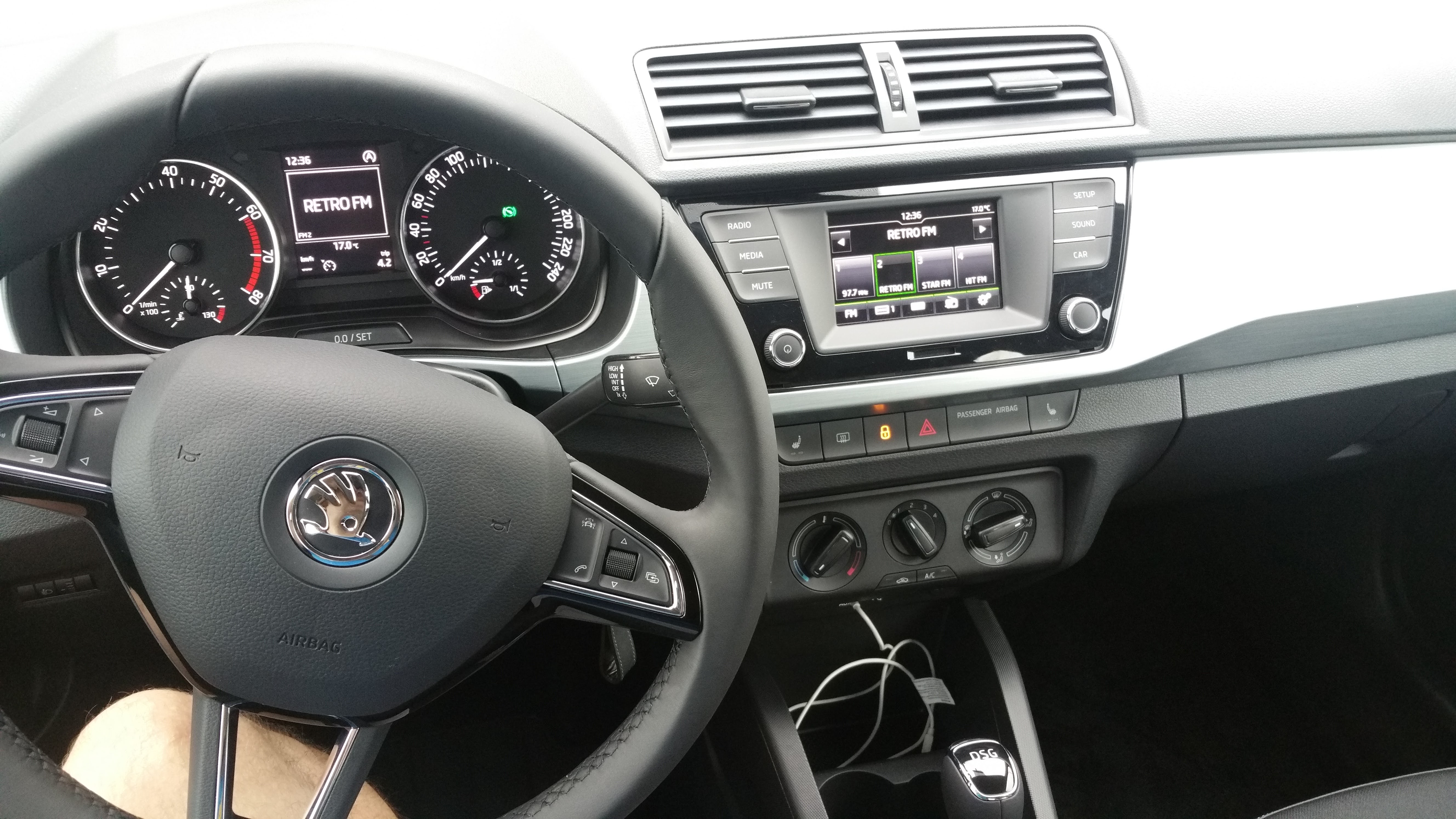

Hi, I finally got my Fabia today. Very impressed with it (SE Combi). I posted the specs in the Fabia register thread.
I have a small problem tho, I ordered the Skoda Surround package but I can't seem to enable it. I have the option in the MFD  but it's greyed out. I also don't have speakers above the door which I believe I should? All I have there is a plastic cover with sealed holes.
Can anyone with the system comfirm it?

Yes, I've got the same radio (Swing with Surround.)
[Edit!]  To change it - press "Media" button. Then press Sound button, and you will find the Surround and virtual Subwoofer settings there. They are not greyed when in Media, but they are greyed when in Radio. I can think of no good reason!

Not having received my car yet, this is just a guess, but maybe the system only applies the surround sound option to media playback, not radio?  The quality of radio audio probably doesnt lend itself to any digital manipulation after transmission.
There is a bug somewhere, it took me a few days to be able to enable it. I think I had to disconnect the phone and use the radio instead of other media source.
If this doesn't work, go back to that screen from time to time until those 2 checkbooks aren't disabled (virtual subwoofer and Skoda surround).

This fixed it. Managed to enable it now thanks very very much!
I think you're right here. The option (although enabled) doesn't do anything when in FM/AM mode.
