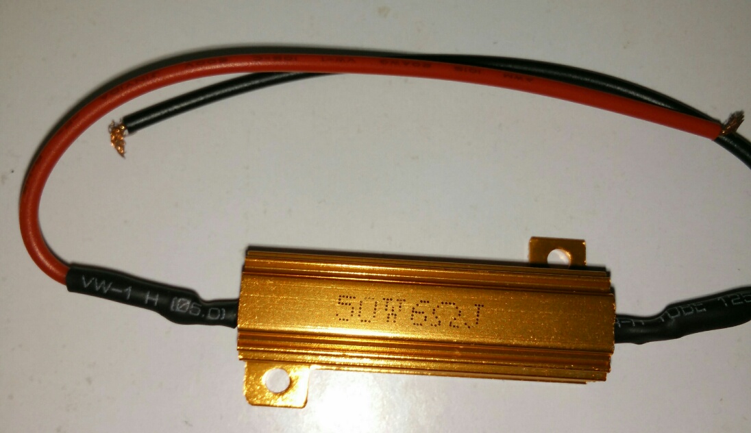

Ok, I ordered some resistors and installed them. Everything works like a charm, but the resistors got extremely hot after 2-3 minutes of hazard lights use. I didn't check with a thermometer but imo temperature was higher than 100 Celsius. So I decided to uninstall them. I'm gonna try to change the relay now.
What rating resistors did you get? (Ohms + Watts)
Edited by SuperbTWM
It's 50W6Ω
Edited by xyannis
