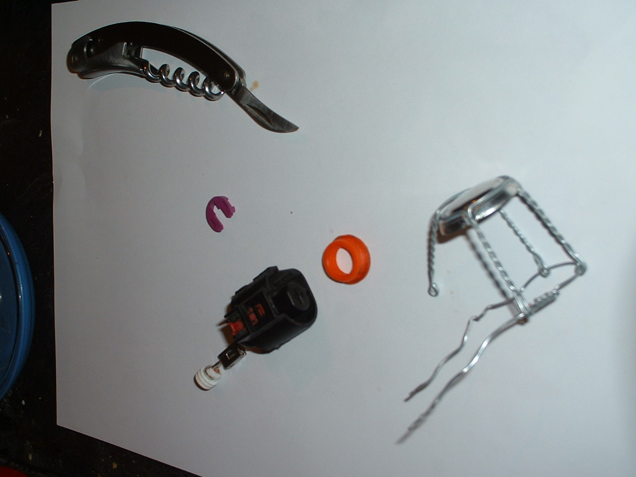

There is another way....  :)
Fabia%20Solenoid%20plug.JPG?dl=0
Get the purple clip out through the slot in the side, then use a handy beer/champagne/whatever wire to push the crimp and contact out the back. White thing is a seal/bung as is the orange.
