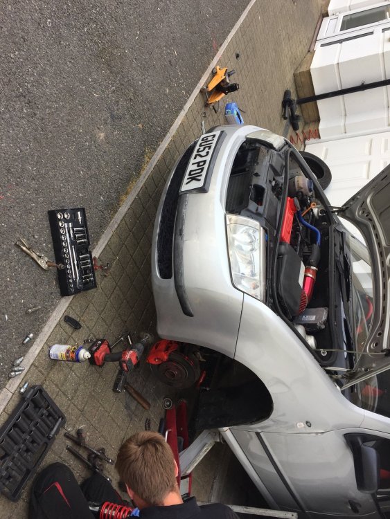

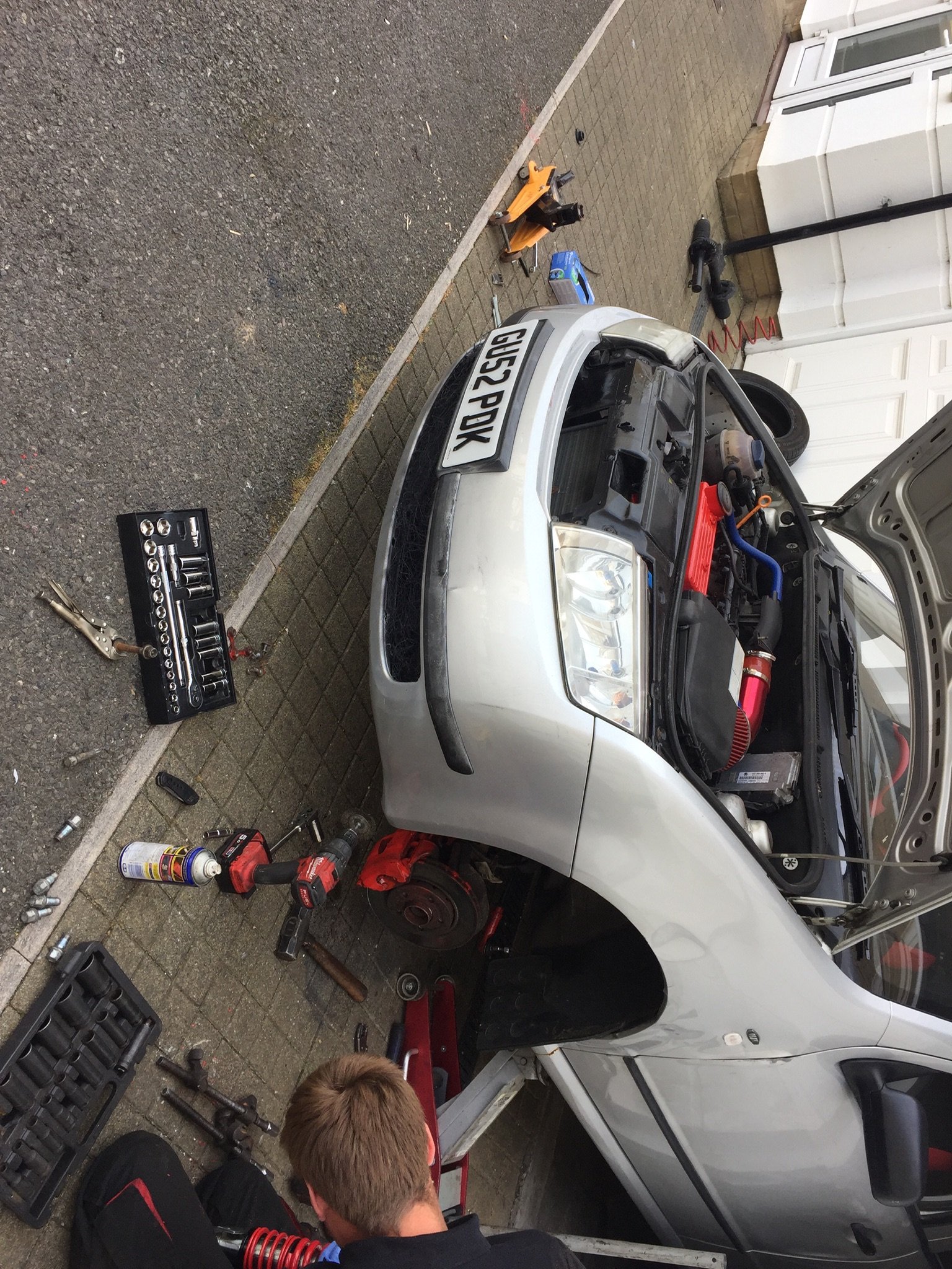

I’ve put coil overs on my Skoda Fabia 6y2, I did have “14 inch” wheels on the car but was scrapping on my front calliper so I put “16 inch” 205/55/R16 on the car instead and now it drives like s*** Any ideas on what I should do, got MOT next month!
You have the wrong tyres, 205/45-16 is the correct size, not 205/55.
Thank u so much probably gonna chuck the “14” inch back on the car for now and get 16’s new tyres :)
