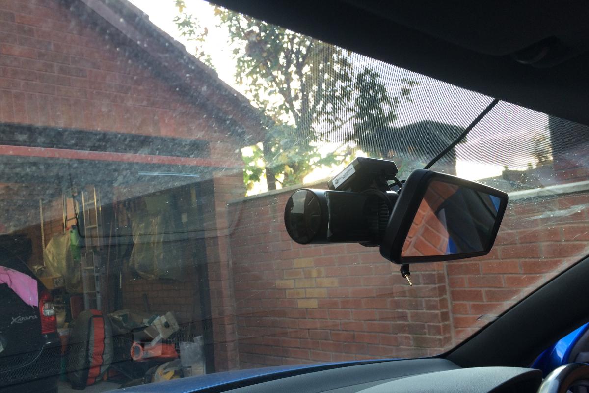

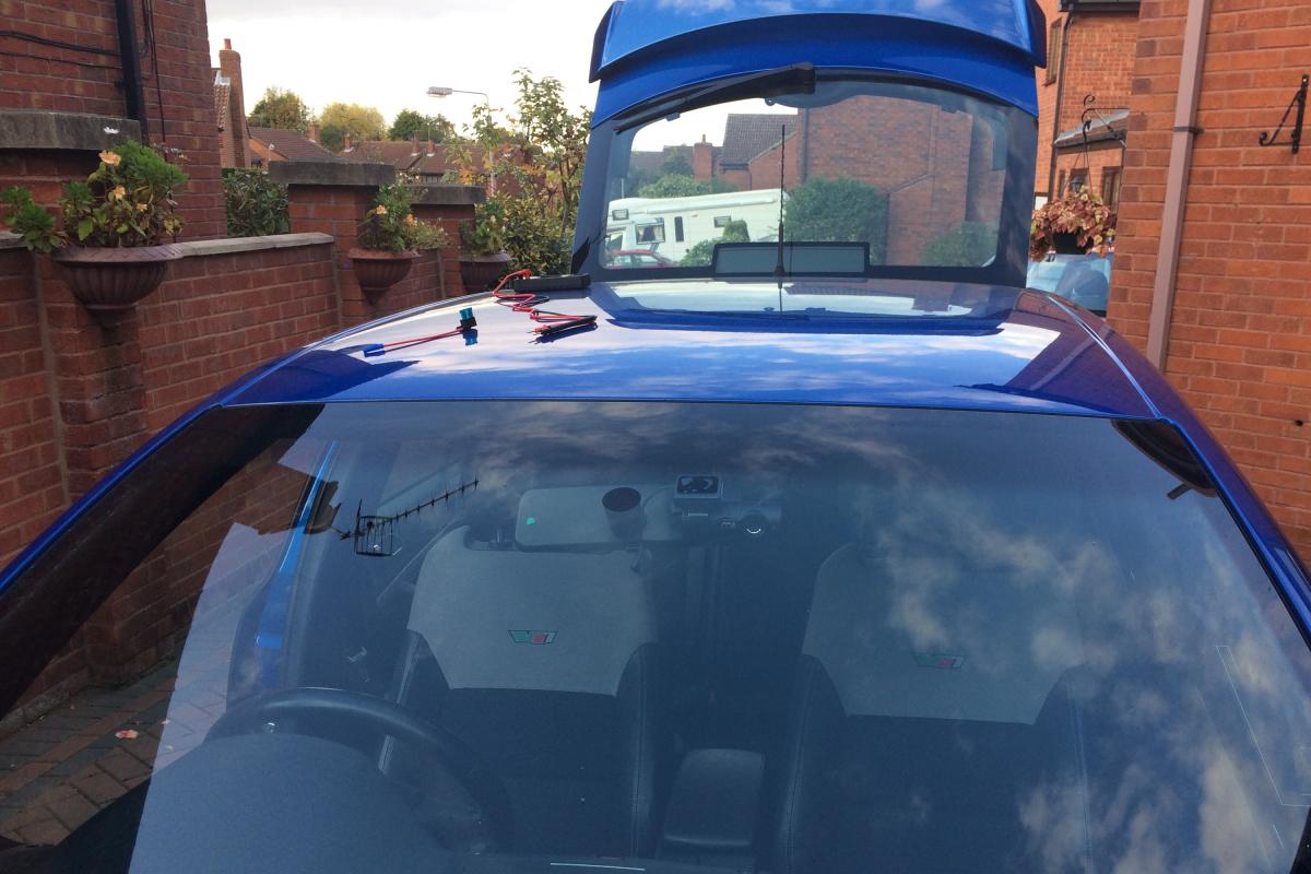

Few pics of the front for everyone :-)

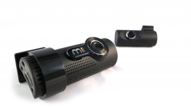

Okay little update.  My kit is a mi witness front and rear so the cable will be coming from the front camera and needs to be led to the rear.  I know i can run from under the seals to the boot ld then I get scared because i need to remove pannels and run it somewhere this is why i am asking for advise :-).
Picture below of the camrea's I have
If all you need to do is run a cable from the front camera to the rear one cant you just run the cable inside the headlining above the doors from camera to camera,you should not need to remove any trim.
You can run the cable in the trim until you reach the back of the rear door then you need to go throught the trim unless you want wires showing :-(
Okay thanks will take a look on my day off then :-)
