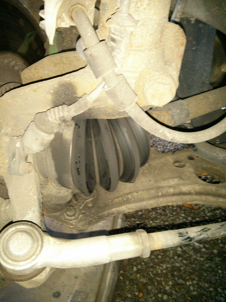

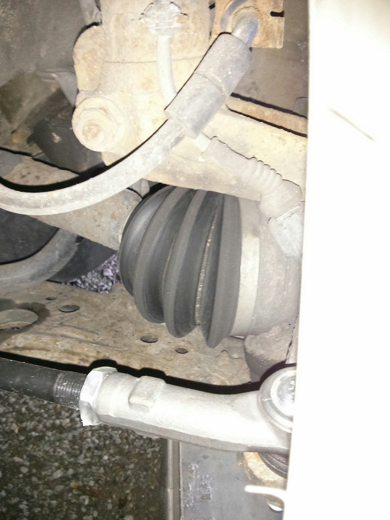

Have attached some phone pics of the rod ends. Both the same orientation but both closer to the wheel than if they were on opposite sides.
To be honest it looks like the track rod ends are on the wrong sides of the car - r/h side is on left and l/h side is on right. I will look at mine tomorrow and confirm, but it does not look right.

I've just checked my track rod ends, and they are fitted on different sides to yours, I also checked the ECP web site and you appear to have them transposed on your car. Perhaps another person could give us a casting vote on this?, bearing in mind I had a new rack about 6 months ago now.
The only way I can think that this happened, is if the rack comes from a TT, then the TRE fits on with the nut on top due to the hubs being different, so in that siuation, they would then be correct. but fitting them to Octavia hubs would render them transposed if the garage is not conversant with the models.

Found a pic of my old rack and it has the TREs on the same way as yours. Also found a pic of the new rack/arms before it was installed and it looks like the TREs were installed on the wrong sides. :(

The garage are saying they have installed it correctly, but have not offered any other explanation for the wheel hitting the steering arm and don't seem willing to fix it. The only logical conclusion I can come to for the arm hitting the inside of the wheel is that the TREs should be on the opposite sides (to match the factory steering geometry for the Octavia and to increase clearance to the inside of the wheel at full lock). Still not sure how this only occurred now and not back in March when I had the rack installed.
