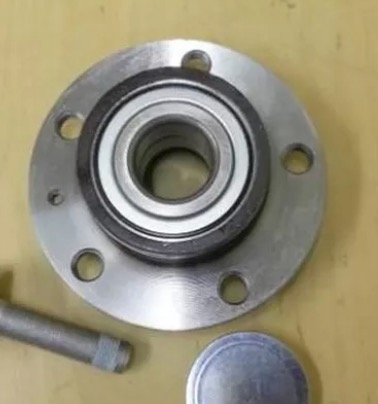

You can see the pick up here on the bearing. As far as I'm aware is not a seperate part. Even if it was the bearing would still have to come off and quite often comes apart on removal. Rust usually builds up in and around it and distorts it so it gives incorrect readings hence bringing the light on.
Been changing them for years for the issue.
