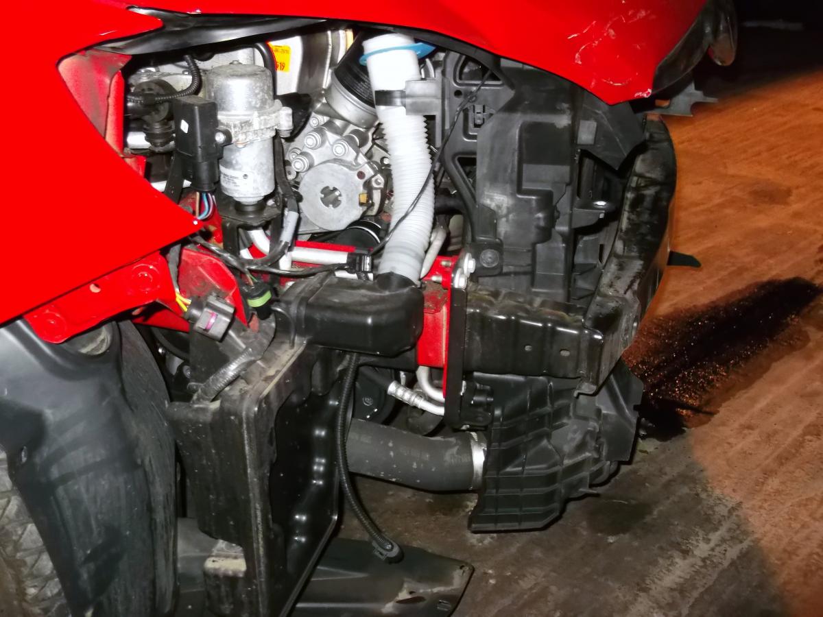

85000km at the moment, had it since 59000km. So far had two regular services at the dealer done, then the oil return tube replaced to remedy oil consumption (now stable around 0.4l/1000km in terms of oil). And yes, as I do tend to fill it frequently it is probably overspill. Left hand drive, first registered 10/06/2010. As far as I know I am the second owner (also according to the documentation). In 2012 it had its high pressure fuel pump replaced, other than that it has been pretty trouble-free experience (apart from keeping an eye on the oil).
Two weeks ago it was in a minor collision - hit a car in front of it, got the front bumper, lights and something else in the front replaced, no damage to the radiator/engine (not sure it needed new lights but it was covered by the insurance so I did not argue). After the repair it seemed to be fine but now it developed this scary sound.

So you many have an issue from the Accident damage.

eg,
Slow speed collision, minor damage, no engine mounts damaged, but front frame cross member replaced, bumper, bonnet., 1 light and bracket,   not cheap.
eg,
exactly like that - total cost was around 2200EUR (but covered by insurance). And yes, it is me with the fuel pump :)
Any idea if this can be related to the timing chain rattle?
EDIT: looking at the picture, I would say that what I saw was even more minor - only the side panels and bonnet were slightly bent, otherwise the front was intact
Edited by zard
