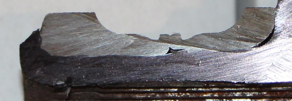

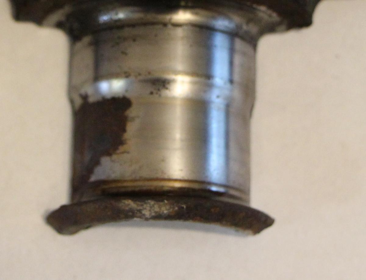

I'll try and take some pictures to show a dismembered hub over the weekend.

Here is the hub cut in half with the inner races removed :-
Here is a close up of the joint between the hub and the bearing inners :-
