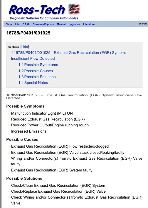

I have had an engine light for a couple of weeks now. A mate has plugged his computer in with an error message of P0401 exhaust flow insufficient.
I have had no change in the car since this has come on i have also cleaned and checked the egr valve. Does any one know what this could be
