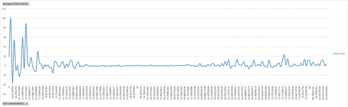

So for people who like data; here are some graphs based on the outbound journey.
Image 1:
EGR command requests against EGR errors (both %s)
Errors seem worse at the low end due to how the error % works (car requests 10% EGR, it delivers 5% = 50% error rate)

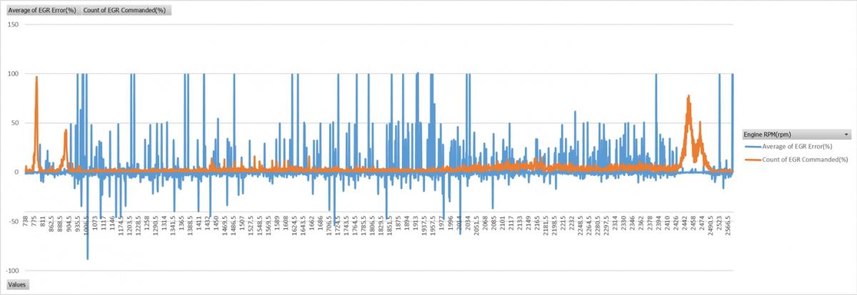

Image 2:
Same information plotted against engine RPM values
Although I don't have a base line of comparison pre-EGR issue; it seems that the EGR is struggling to meet it's requested values regardless of the % request or engine RPM level.
Going to proceed with the EGR being replaced; but want the old unit back from the garage so I can have a look at it afterwards.
