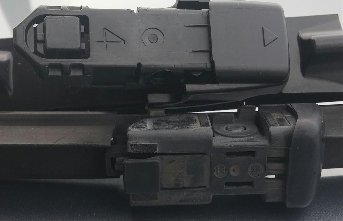

These came with a multi clip and i cannot figure out how to get them on.
I'm using clip 4.

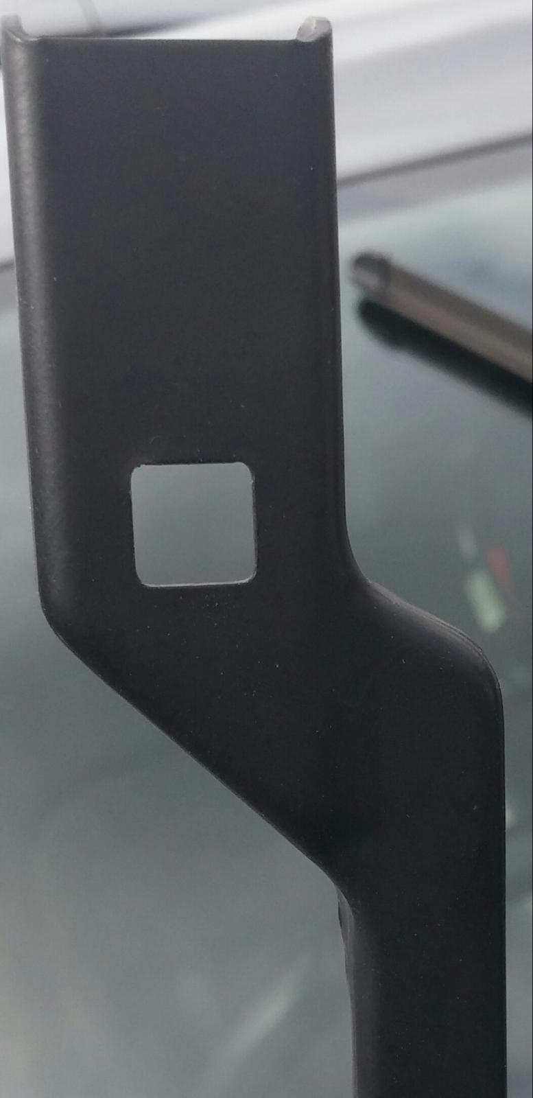

Picture of old and new wiper side by side

I fitted some of these last week. They come with a variety if adapters - just compare the adapters with the old wipers and it should be obvious which one us correct. It's the one with the button release thingy. You just push the adapter on to the blade and slide the whole thing in to the arm - the button will click into place and you're done! Dave
They came with 4 clips, the closest appearing to be the one in the pic. Tried with no luck to fit.
I've changed wiper blades before on other cars but confused whether the correct adapter is included with this wiper.

Halfords say adapter 2 mounting A for the AP18U. They also sell the original Skoda fit for £28 for the front pair. If you know someone with an Halfords trade card you can get a heftey discount on their own brand
Thanks guys, Heli it does turn out i had to use adapter 2 mount A(inside 19mm) and a bit of tugging and job done!
Drefaldwyn did you fit these same Bosch ones on your car?
Yes .... The correct adapter, for me at least, is the one on the rhs of your photo.
