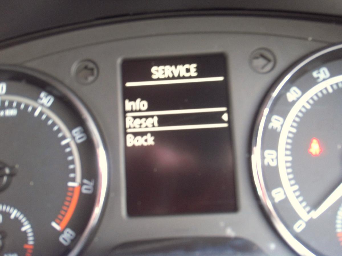

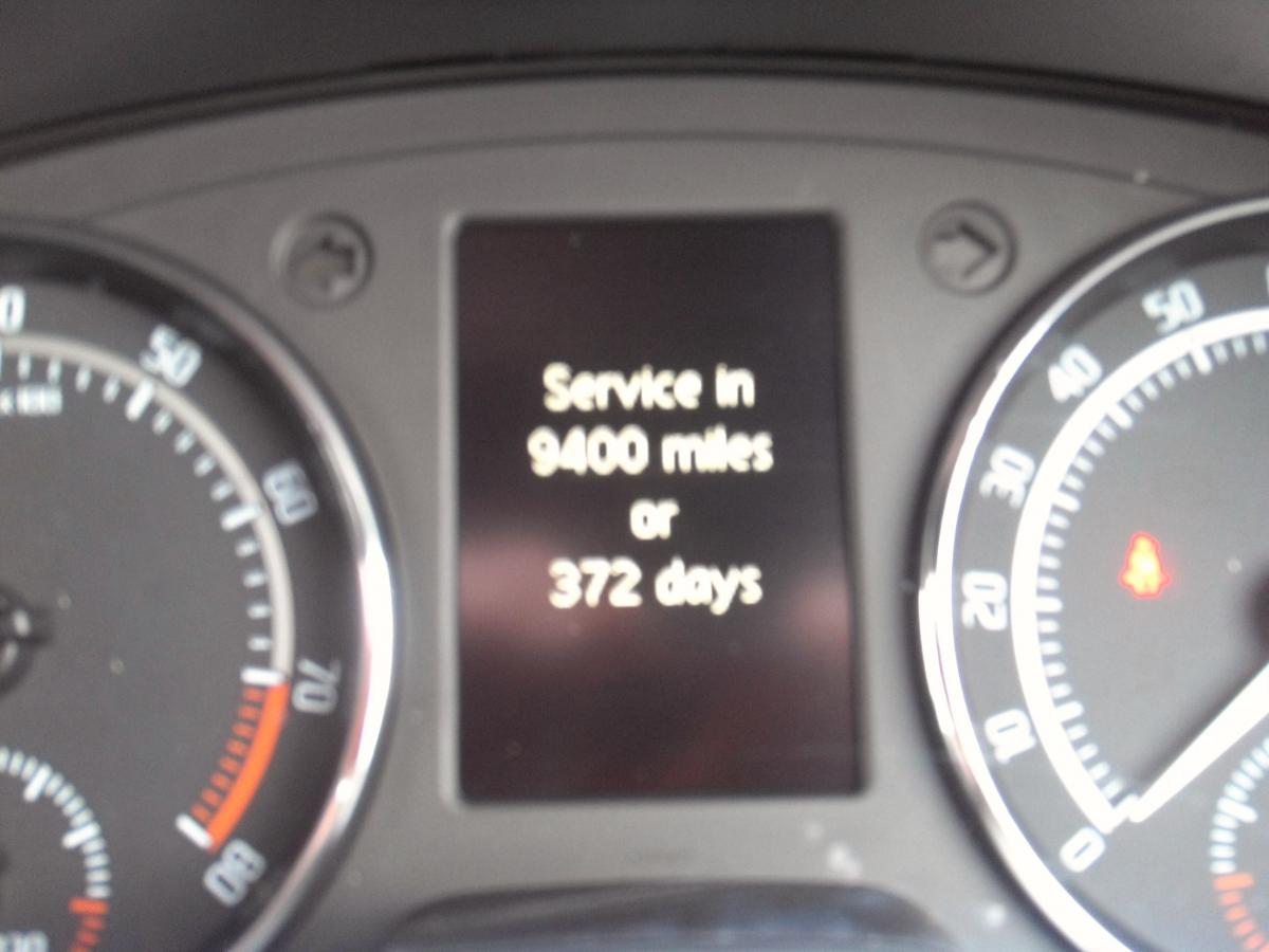

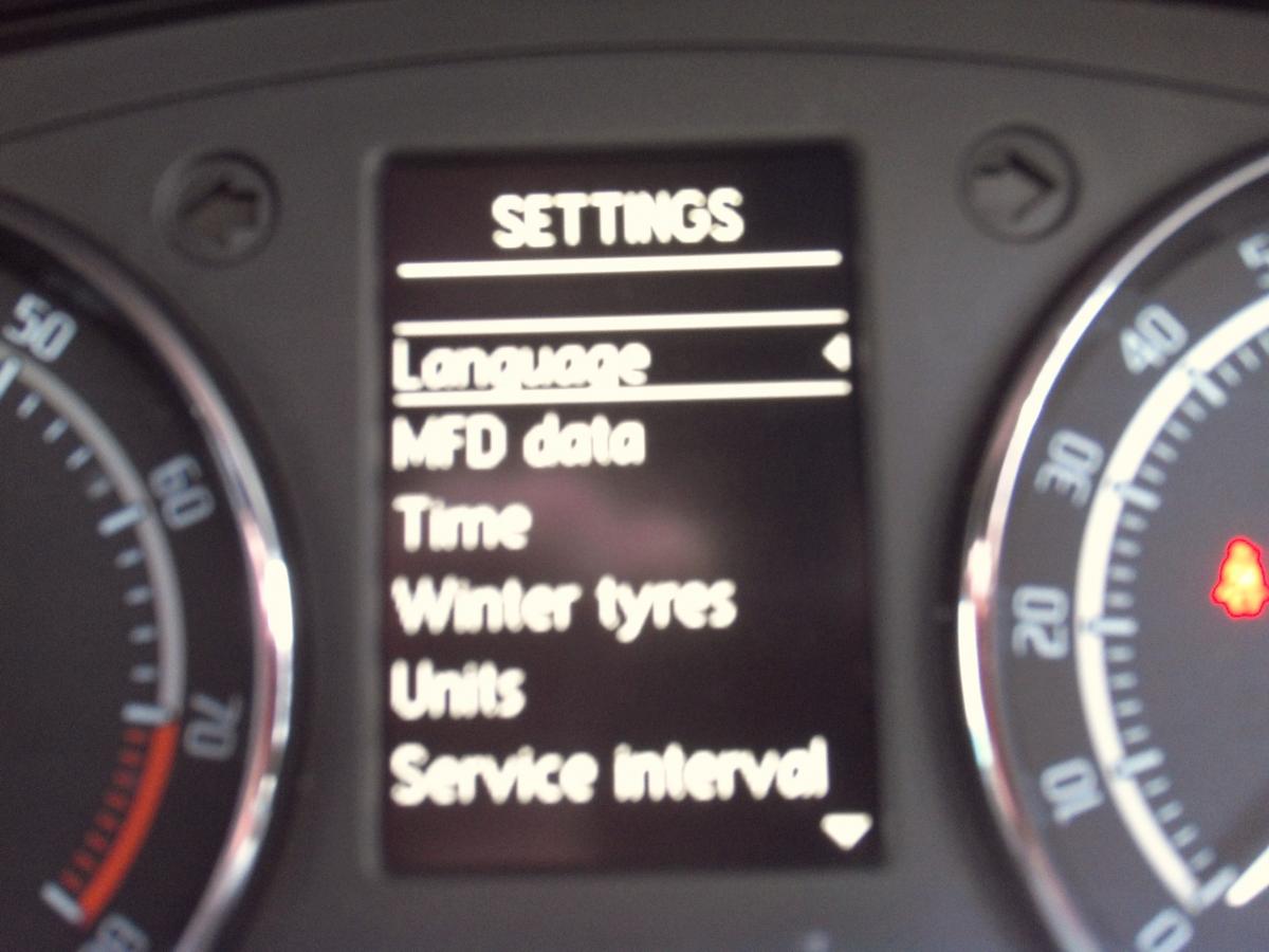

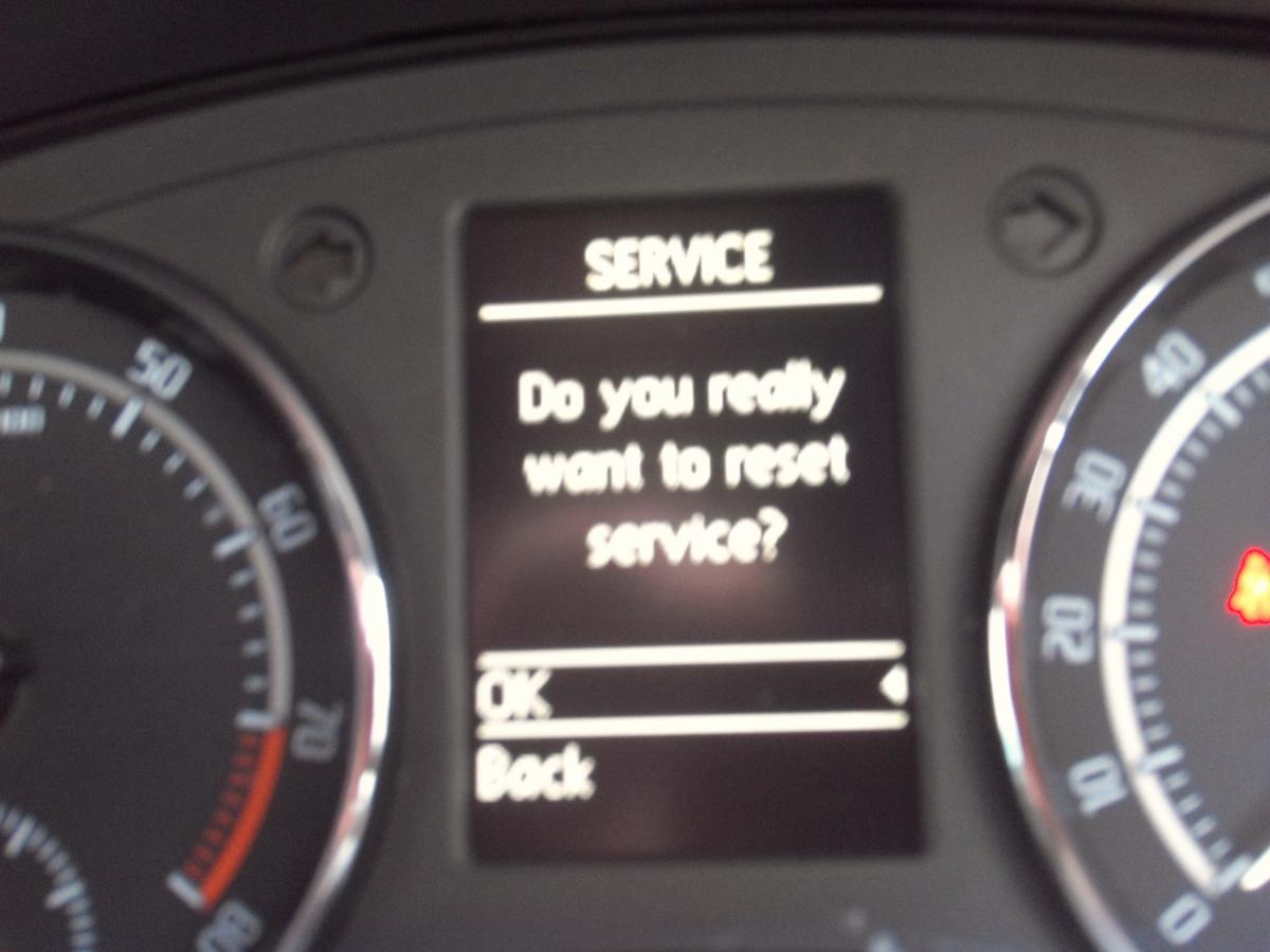

Have you tried yourself from the Menu Choices?
It should be available unless someone changed the car to variable servicing or messed up the set up and lost your choices.
One thing I've never actually looked through and owned car two years.
Just done it now & it's reset. Thanks for your help Buddy!

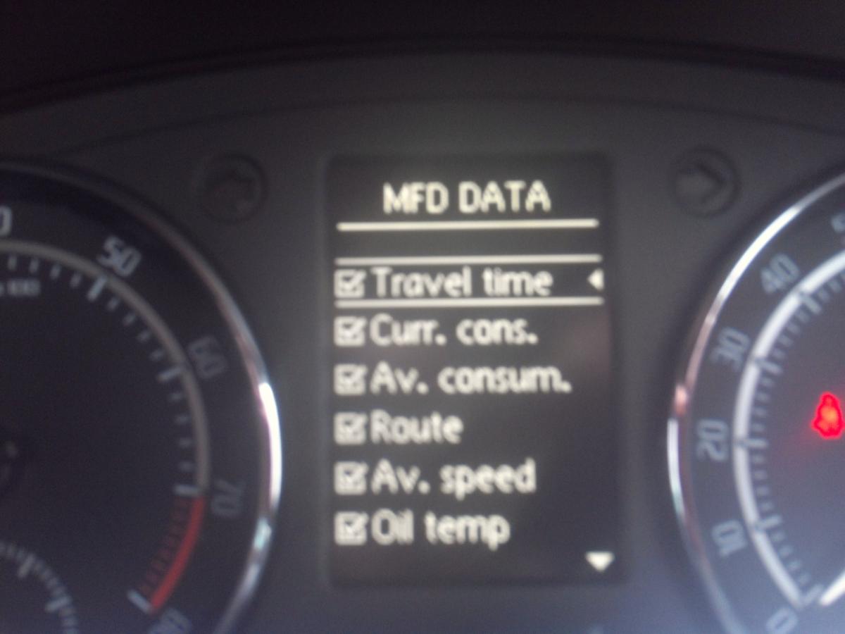

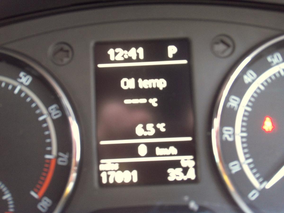

So now you see some choices.
Set a Speed Warning for Winter Tyres if you fancy, then you have another for just Speed Warnings,  Handy IMO.
I'll have a good flick through the settings when I have some spare time and see what's there. Thanks again!
