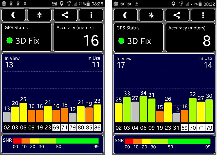

Ok. I have heated screen, lane assist, Columbus - not sure about the rest - standard UK L&K.
I've just compared outside the car with inside next to the screen:
Inside:
Outside:
So slight signal degradation but not much. For a test I did the same in my wife's Hyundai (no heated screen) and it showed a broadly similar amount of attenuation.
Edited by Kungfugerbil
What app are you using ?
App is "GPS Test" on Android
