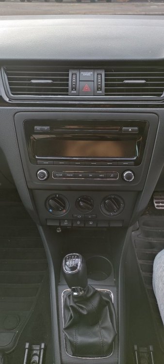

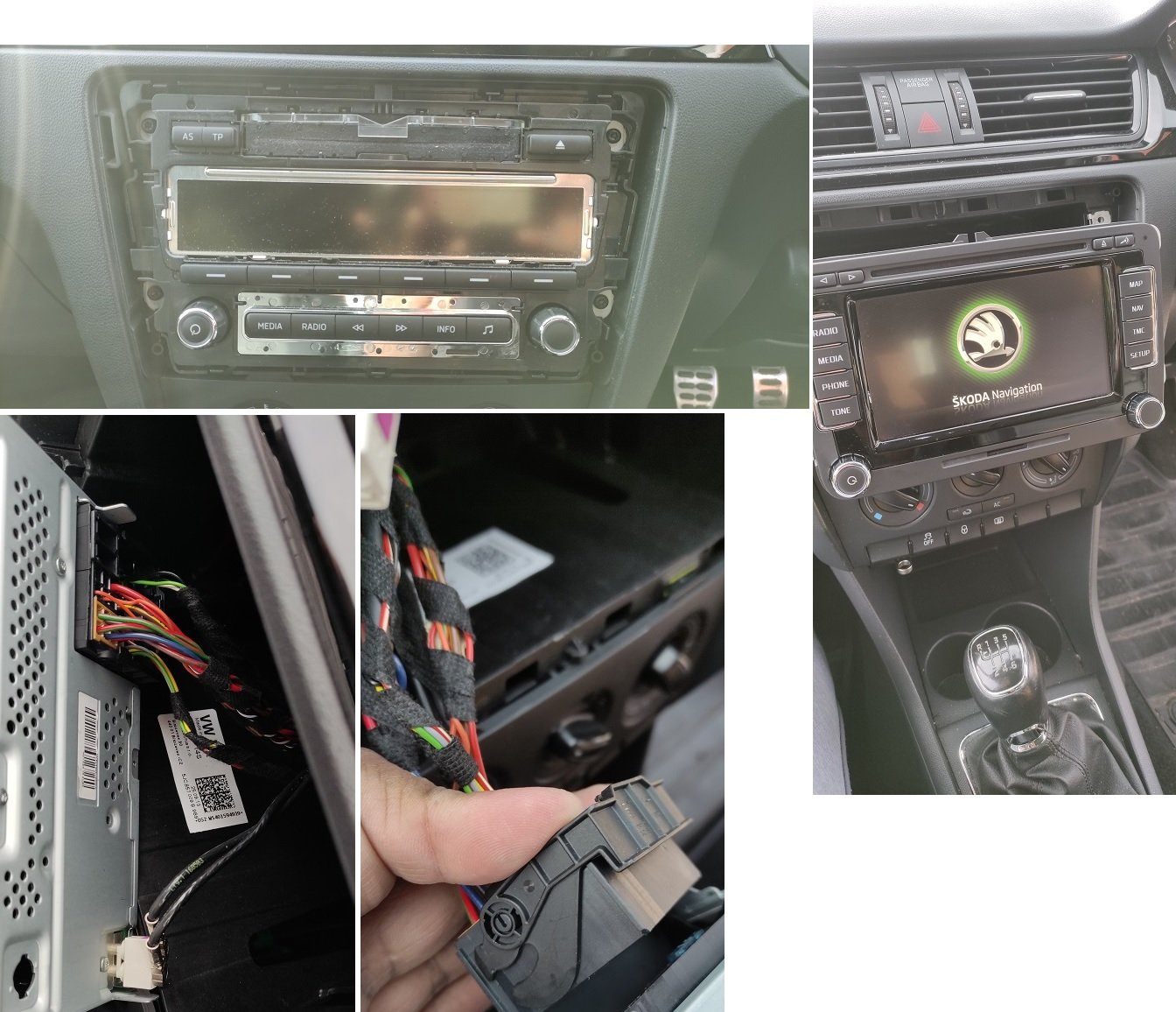

The Swing headunit was the standard option on the Rapid. It has FM/AM radio and a CD drive. It interfaces with the USB and AUX ports below the heater controls (known as MDI), an external Bluetooth (module to provide calls and music playback and displays information on the instrument cluster (known as Maxidot). If you have OEM parkig sensors they will also display on this unit too. If you have a multifunction steering wheel (MFSW) this also controls the unit.
1051251114_SkodaRapidColumbusRetrofit0.thumb.jpg.e88861b274c04f2c369ff53717da2bc9.jpg

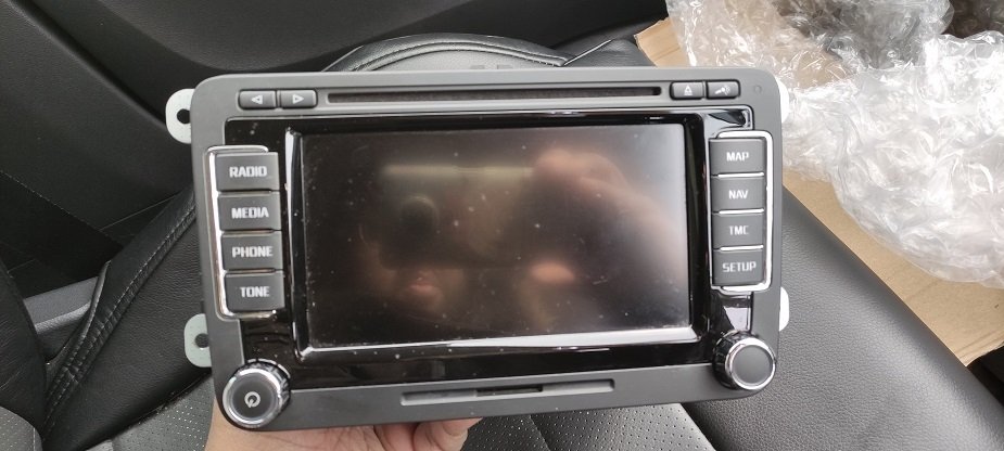

The Skoda Columbus headunit was never offered an an OEM option for Rapids but is a popular retrofit option. This headunit is also known as the RNS 510 which is the VW variant of the same headunit and only differs in the backlight illumination (green for Skoda, red for VW) and the startup logo.
This is a touchscreen navigation headunit with a DVD drive (you can watch movies on it while the vehicle is stationary) which also interaces with MDI, external Bluetooth and Maxidot like the Swing. It comes with its own SD card slot and a hard drive to store music on. It also displays parking sensor information if you have them fitted, MFSW compatible and has voice control.
Additionally some come with DAB / DAB+ and the hard drive can either be a traditional HDD (spindle) or SSD (a big memory card) each with different storage capacities. On top of all that the screen can also either be LCD or LED (newer).

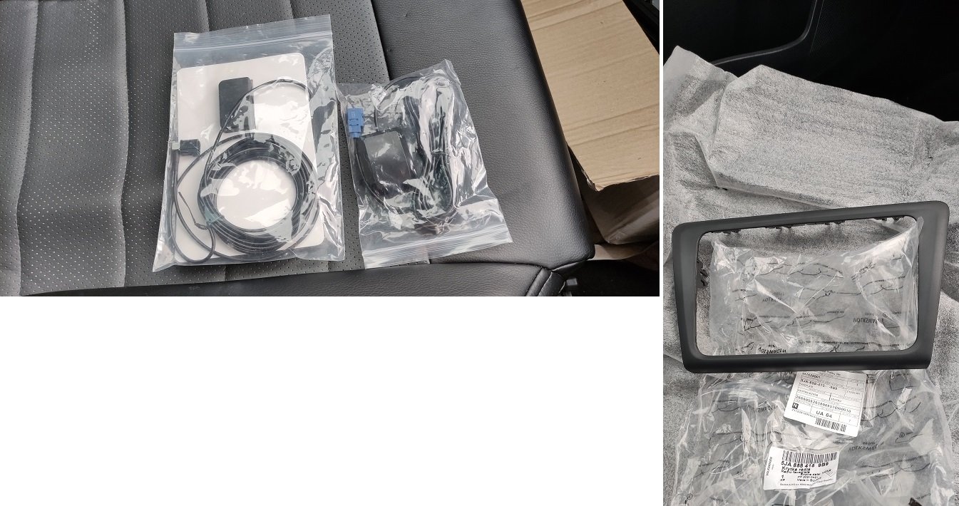

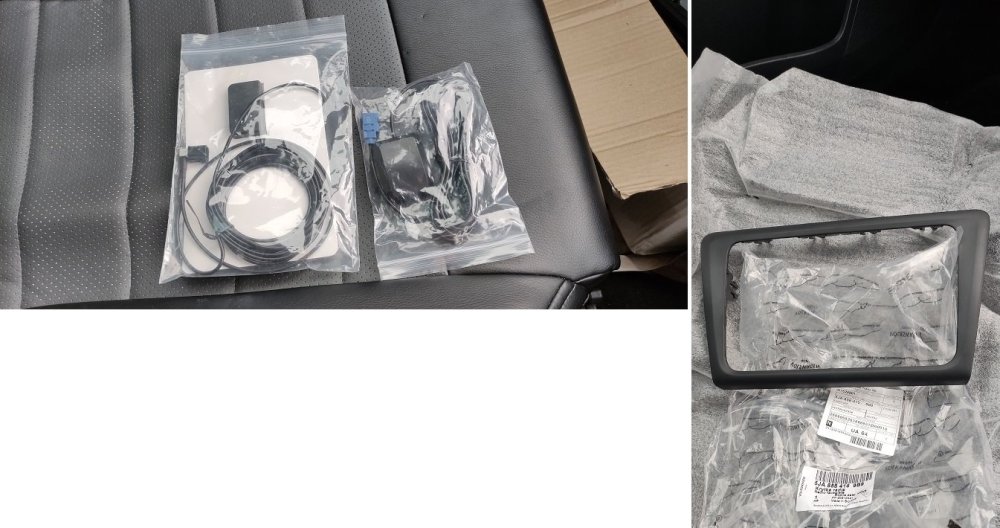

A GPS antenna for the navigation and if your unit supports it, a DAB aerial too. These are around £10-15 each for the simple stick-on types. The connector types are Fakra. You will also need a new surround which can be purchased from a Skoda dealer (I paid £7.50), part number 5JA858415 9B9.
1994496121_SkodaRapidColumbusRetrofit226.thumb.jpg.b71a86e646cf7a0d1feb946f4407273d.jpg

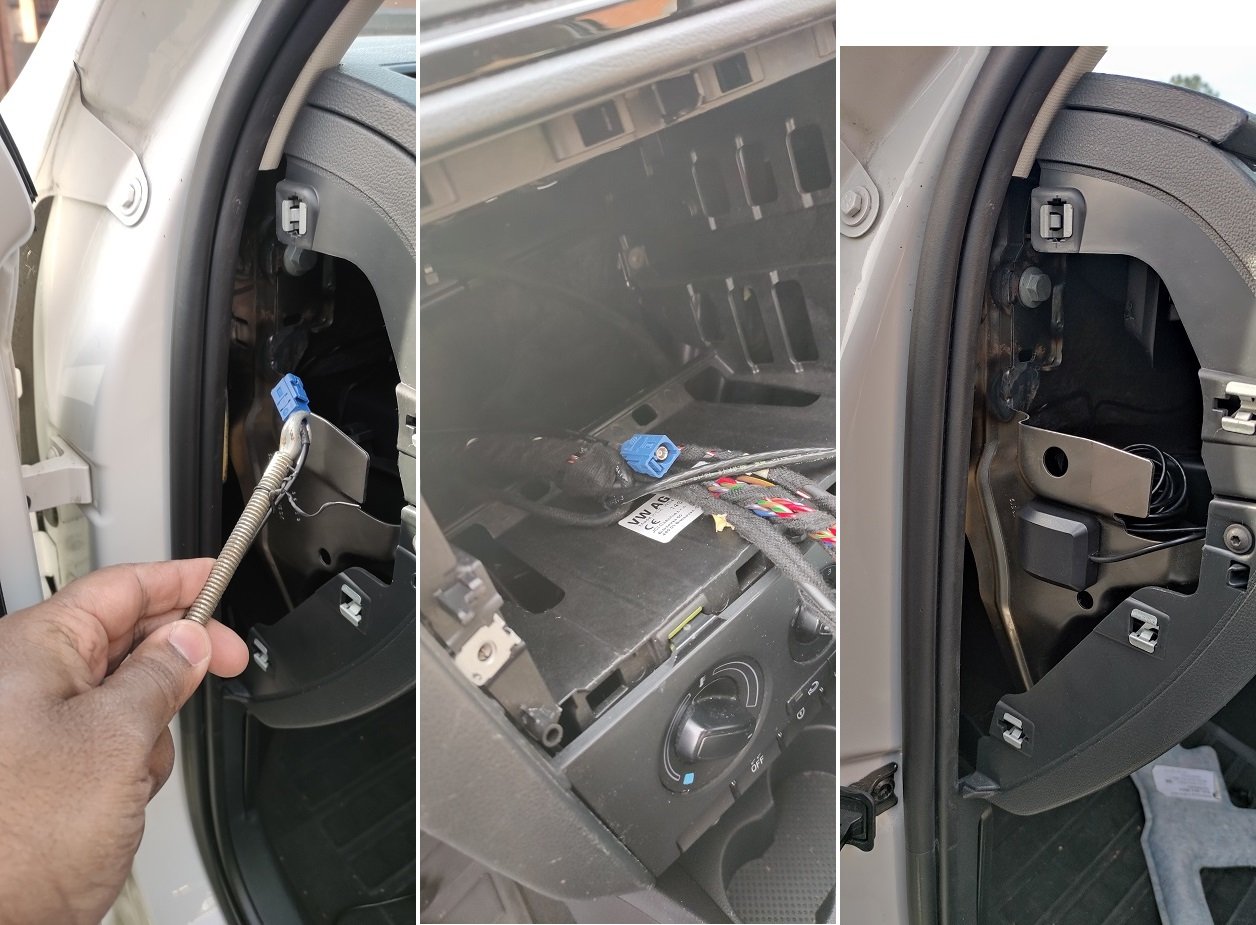

Let's start with the GPS antenna. This should be stuck on to a metal part of the vehicle. I decided to put mine on the metal on the side of the dashboard. It's easy to get to and gives good reception (more on this later). Some stick it behind the unit on a metal part of the frame too.

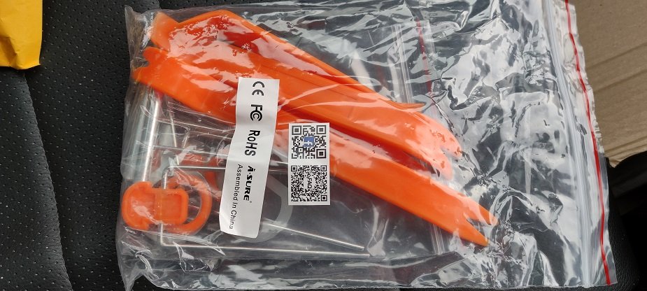

I'd recommend investing in some trim removal tools which are only a couple of quid from eBay delivered.

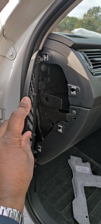

Remove the side trim using a trim removal tool or you can push it out from the back if you get your hands behind the trim by going under and behind the glovebox where the fuse box is. There's three clips which disengage once you apply some pressure.
Once this is removed, you can see the metal where the aerial can be stuck. I put mine on the outside, some have placed them on the inside too. Stick the antenna on then you need to thread the wire through to the headunit along the top of the glovebox. If you have another pair of hands or very thin arms you can just about get it through; however I ended up using a drain unblocker tool which is flexbile enough to poke through the gap while being rigid when pushed; tie the end of the antenna to it then push it along until you get to the headunit. There is a small opening to the left of the headunit where you can thread the wire into. Once through connect to the headunit (the blue connection at the top).
1066173718_SkodaRapidColumbusRetrofit11-13.thumb.jpg.7254365139fe4e75144694eea4d4c7d2.jpg

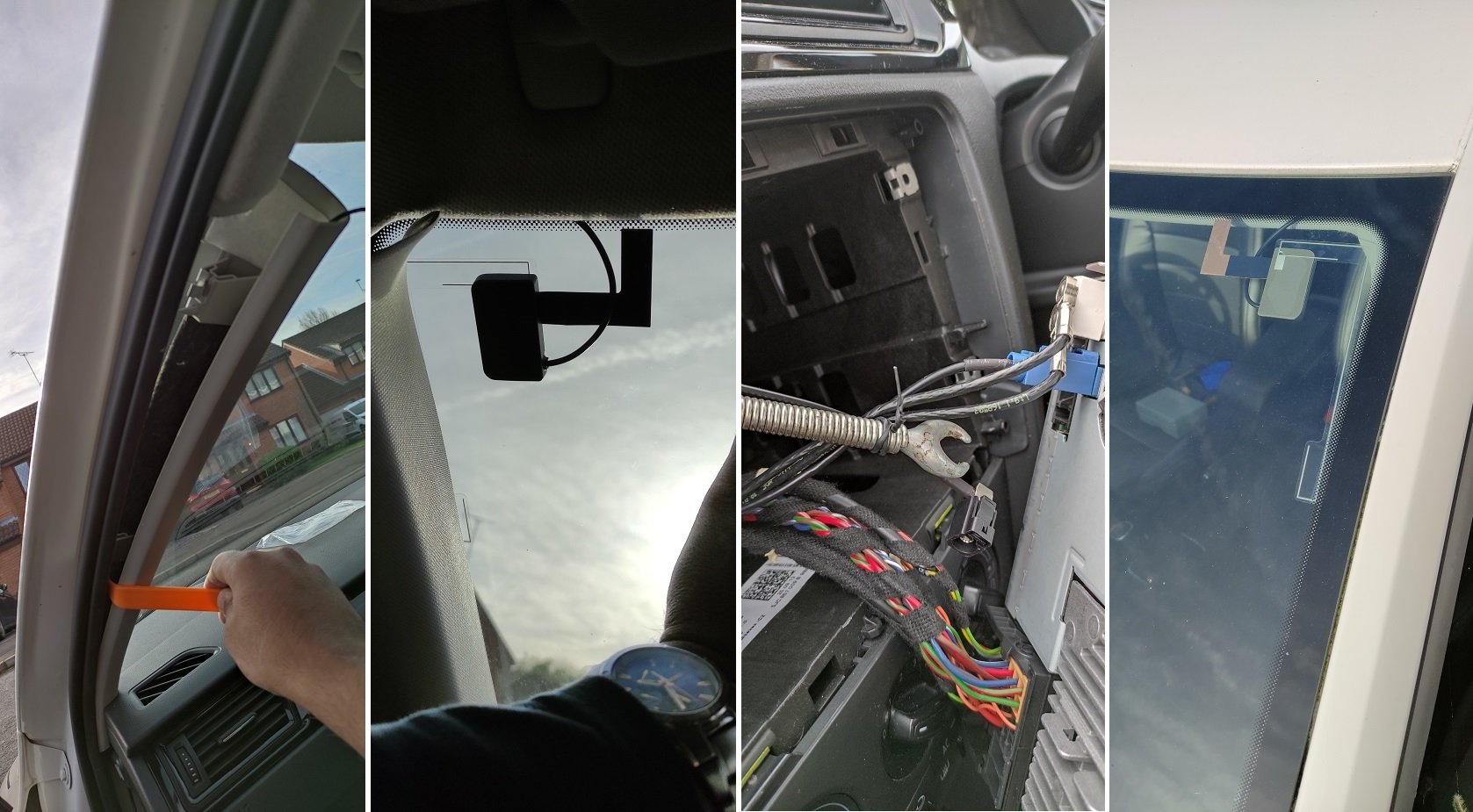

I placed my DAB aerial on the top-left corner of the windscreen, it's a stick-on type. You will need to remove the pillar trim using a trim removal tool then feed the wire down the pillar and back through the top of the glovebox. I also tucked my wire at the antenna side into the headliner then down for a neater finish.
407281290_SkodaRapidColumbusRetrofit14-1621.thumb.jpg.8de211f09835c0bc6c0f0d8041cd7139.jpg
You can get other types of aerials - I'm considering an all-in-one sharkfin which has FM/AM, DAB and GPS but it would require routing the cables from the back of the vehicle. A neater solution if you can do it (I was quoted around £300 by a local car audio specialist for this).

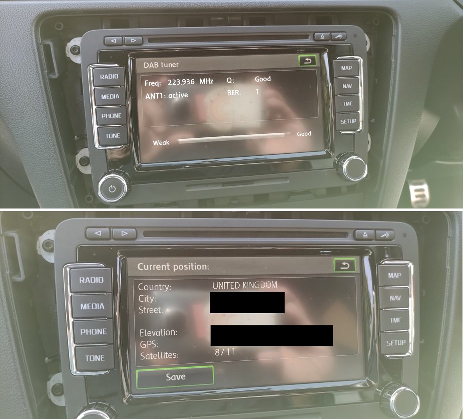

Once done, give it a test - there are settings in the unit which show the DAB and GPS signal strength. Mine were fine for my area. Put all your trim back and get the kettle on - you deserve it.

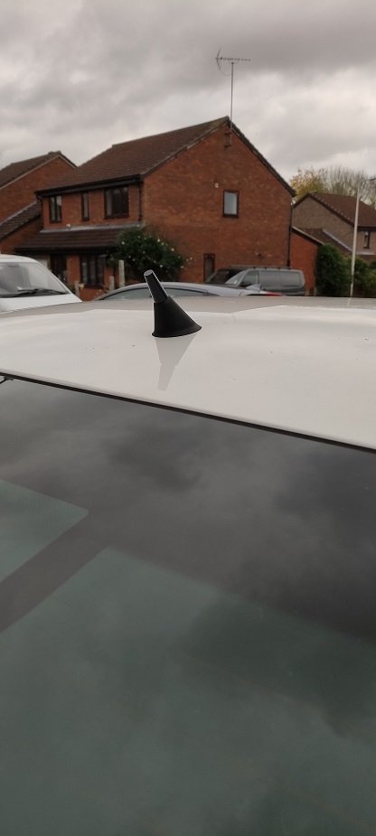

If you have DAB, you probably won't need be listening to FM/AM, so now's the time to ditch the fugly long aerial and replace it. I went with a 3cm stubby variant, very low cost but looks so much better. I don't think a sharkfin would work as the roof is slightly sloped at the back which means it may not sit correctly - maybe one to try out in the future.
